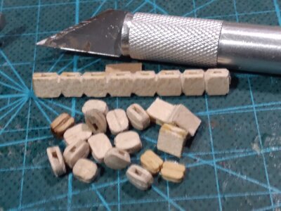

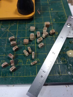

I've been experimenting with maple, alder, cherry and poplar. Maple is very dense and harder to sand than cherry. Alder is soft enough to cut and sand but hard enough to keep its shape. So far I like cherry and alder the best; their 20210402_103142.jpg20201120_172622.jpgcolor is good and holds the details of cutting, drilling and sanding.
