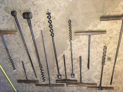

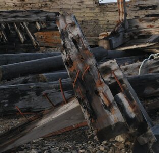

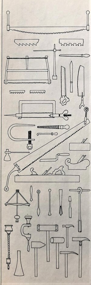

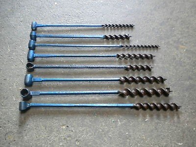

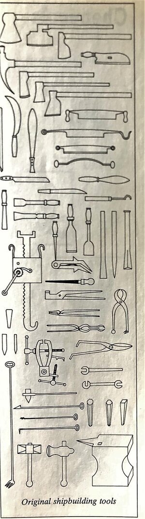

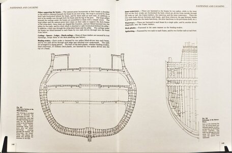

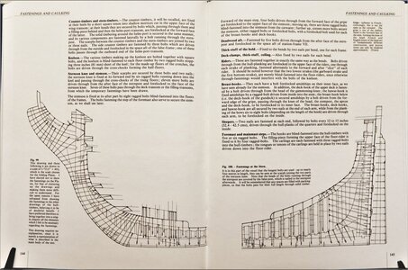

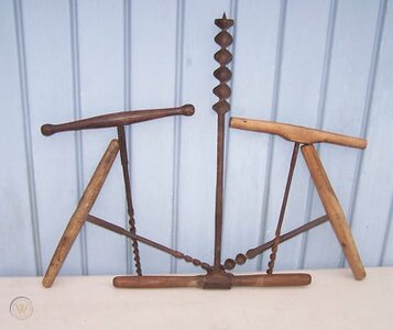

Did the original shipbuilders drill holes to ease the insertion of iron nails? The length and thickness of the nails must have been difficult to drive in without it.Dsc_2199.jpg
