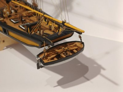

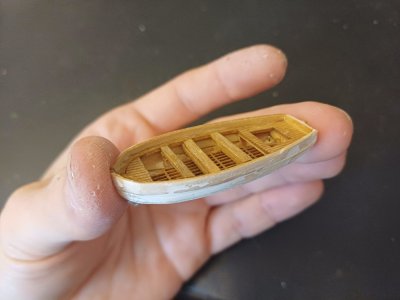

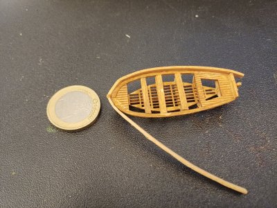

I have the kit with the little lifeboat, and I figured if I'd be able to make that one first I'd definitely be able to do the planking on the main ship.
After the lifeboat I got started on the main hull.

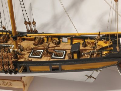

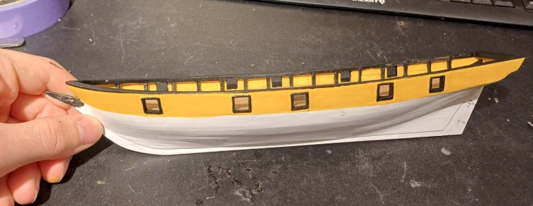

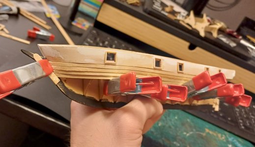

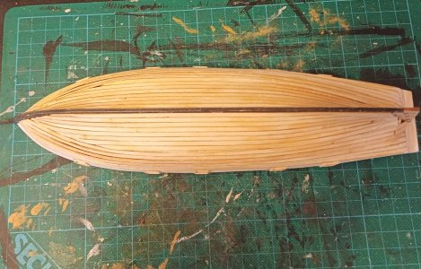

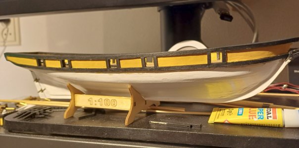

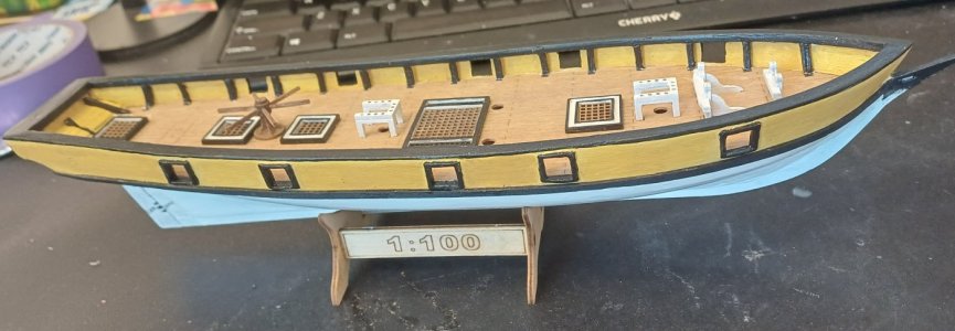

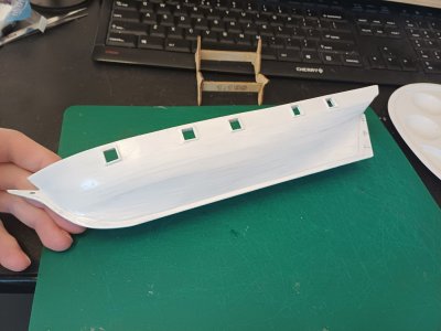

The planking took me a good few evenings of work and didn't turn out perfect, but nothing some wood filler, sanding and painting couldn't fix ;) I had already decided from the start I was going with a painted hull and not with a stain since I was pretty sure I wouldn't be able to do the planking good enough for a nice finish.

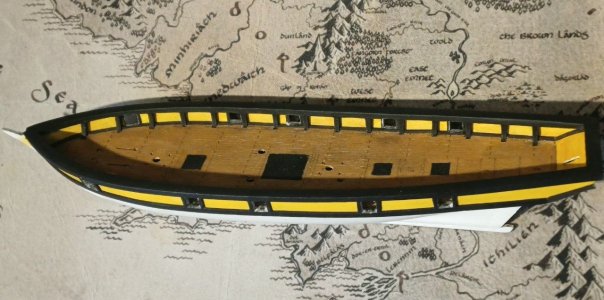

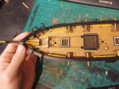

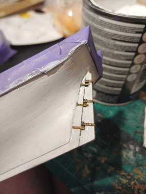

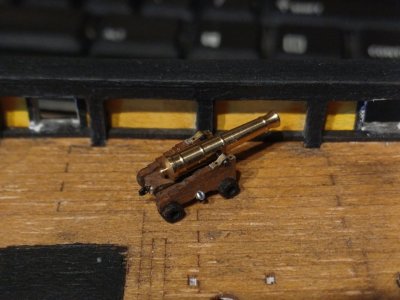

As you can see I decided to add some detail to the gun ports, partially inspired by another build, partially because I snapped one of the sides right at a gun port while dry fitting and wanted to strengthen them a little.
When I started adding colour to the build I wasn't quite happy with the look of it especially after adding the wales to the hull. It just looked messy and unbalanced. Sooo... I took it all off and redid it all, moving the wales a bit higher and lined up perfectly with the edges of the gun ports. I had some leftover planks so I added them to the tops as well as adding a nice edge detail at the stern. Very happy about that change, it looks so much more balanced this way.

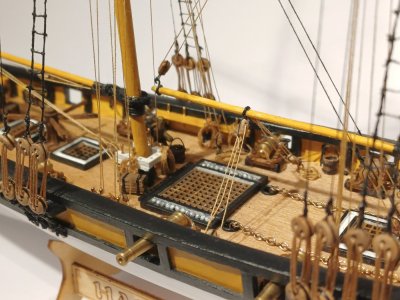

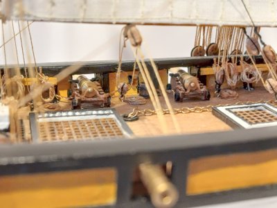

Added some detail to the rudder with small strips of planks painted with gold/copper paint to match all the other copper details like the chains and cannons.

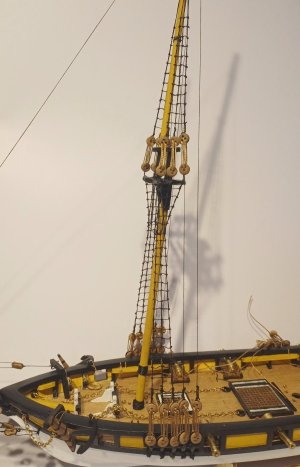

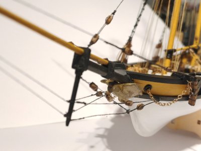

I bought some 6 mm (brass?) belaying pins from china that fit well with the scale and colour scheme I'm going for, as well as some chains for the anchors.
I'm on a bit of a budget, but also a bit of a perfectionist so I wanted the main details to look at least mostly right.
So I also got me some 4mm deadeyes from china, which was the smallest size I could find for a reasonable price (€2,20 for 20 pcs.)

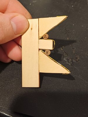

I made a little jig to make sure I'd be able to get everything at the same length.
That's it for now. Interested to hear what you all have to say :)
Well I'm almost done with the build, here's some more progress:

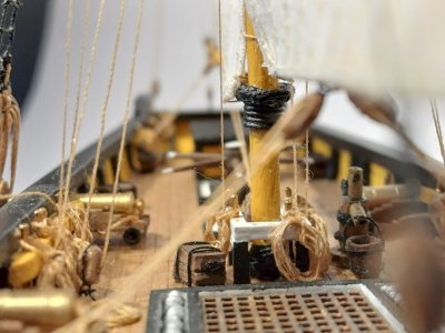

Here the little jig I made for the rigging, the deadeyes can be pressed snugly in there before threading the rope through. Worked great for making all a consistent length.

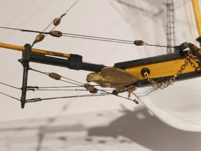

I made a small figurehead out of air dry clay, it had some sort of fibre in it which made me able to use a Dremel to carve it into a bit more detailed shape after it dried. It's painted with some simple gold paint afterwards

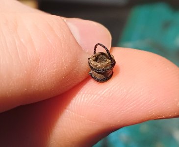

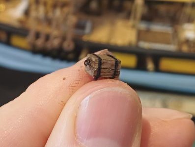

The same clay was used to make a few buckets, some small planks for the crates. The ''iron'' details are just glued string.
The cannonballs are also made from the same clay, I was looking for some small ball bearings but couldn't find any that fit.

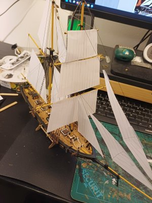

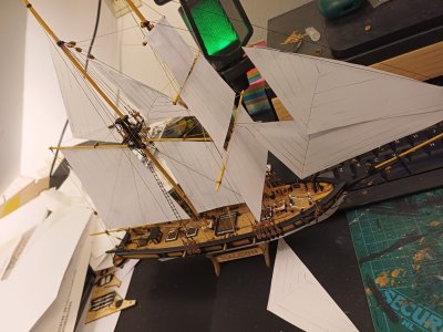

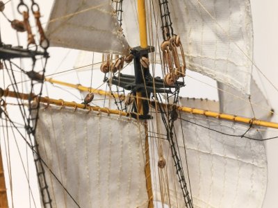

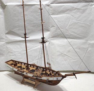

Very happy with the added details. Now It's time for the sails, I did a little mock-up with paper to fit them.
This is the sails according to the template that came with the kit. The fit was a bit off so I tweaked them a bit.

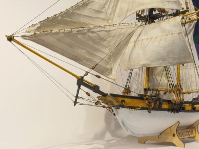

I decided to go with just two jibs, with the way I had rigged the masts I couldn't make it look nicely in the other configuration.
Now all that's left is sewing the sails and rigging them.

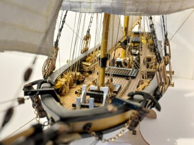

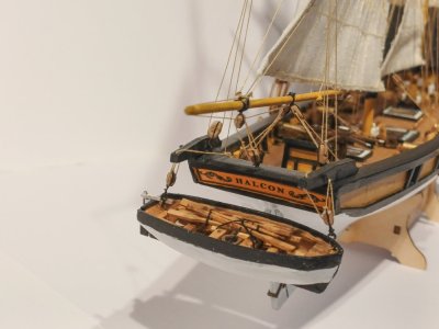

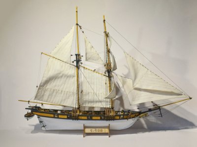

It's fully finished, very happy with the end result. the sails were a bit of a pain to install but worth it for the end result.
I sewed some metal wire into the edges of the sails so I could form them a bit, makes it look a lot nicer than the sails just hanging straight down in my opinion.
For the name on the stern I went with a simpler design because the ornamental one with the falcon that you can find online is quite poor quality and would also not match the colour scheme of my build. I measured it close-ish, made a design in illustrator, printed and adjusted it until the colours matched and it fit perfectly.
I only noticed after installing the first jib that I had swapped them around, the stitching would've lined up otherwise but I didn't feel like redoing it in the end since it looks fine and most people won't notice. I'm planning to build the kit one more time and do the rigging more accurately anyway, once that one is done I'll probably sell/gift this one.
