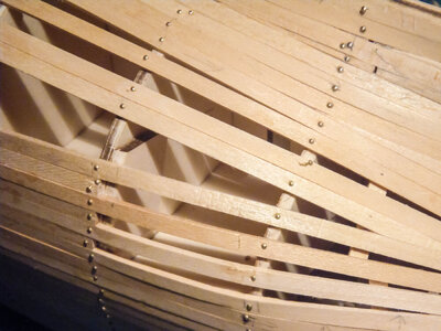

Although second planking is already over and done with, I have decided to start a build log on HM Bark Endeavour by Occre. This is only my second build, the first one being HMS Endurance, also by Occre. The difficulty of this kit is listed as 'high' whereas Endurance is listed as 'medium'. My experiences up till now with Endeavour have confirmed that it is certainly a more difficult build than Endurance (which for me is a good thing).
Below is - in reverse order - an impression of the build so far.
