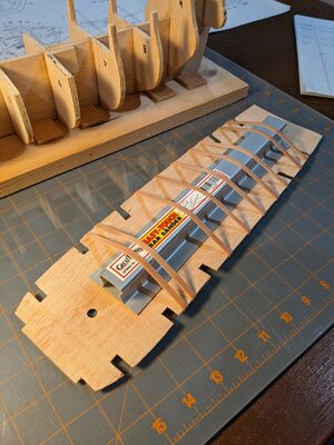

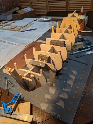

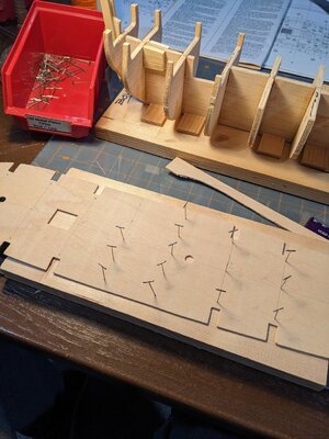

After gluing and a light shaping of the stem-head strips, positioned the ribs for gluing. BTW, I'm using Gorilla wood glue, seems fine for my purposes here. While I've used CA glues, the odor is really objectionable and if I need to use it, I do so in the garage. For now, I'm set up in the basement. The false deck had a little twisted warp in it, and with some rubber bands and a light spray with water, I got it to lay a little better in preparation for laying on the ribs.grimsbyRibs.jpggrimsbyWarp.jpg

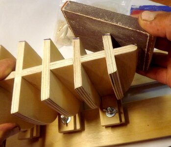

Thanks, Bryian. Seems to be holding up so far. This jig is pretty much a one-off, I'll want something more adjustable for the rest of the fleet...

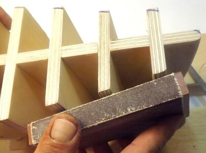

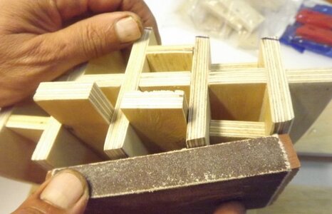

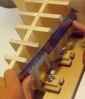

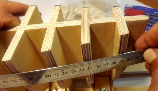

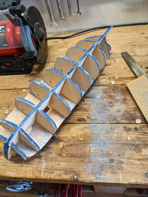

The plans suggest using a marker on the frames in advance of shaping, so here's a shot of the resulting mess after using 60 grit on a sanding block. Still lots more to go, and I'm checking progress with a plank to find any high/low spots. I think it'll work out. Next up: Finish shaping and then build a jig to bend the planks.PXL_20231026_164508951.jpg
