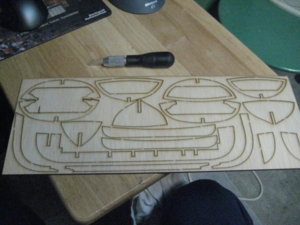

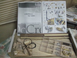

Anyone that have build an OcCre kit before already know how well ant the attention given to the packaging. It come as usual with an instruction booklet and a step by step photo manual. All the parts are laser pre-cut and very clean.

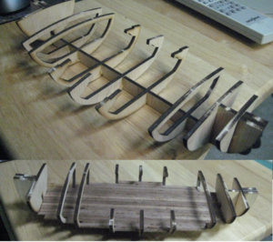

The frame is made from strong 3.5mm plywood
And the laser cut made a precise fit
All the piece fit together perfectly and give a strong and perfectly straight hull

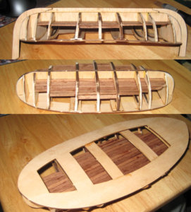

This is follow by building the floor and the pose of the deck

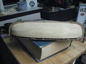

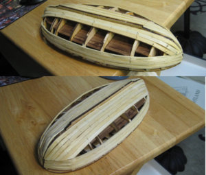

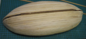

The hull planking start by installing 3 plank install 7mm from the edge

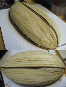

The planking continued with plank that goes from one end to the other photo
Just to show how it is possible to mist completely and I did not try to do any correction on it.
The reason was to show when you have 2 layers of planking how it is possible to made the correction and have a nice hull at the end

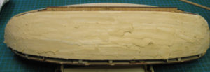

More planking of the hull

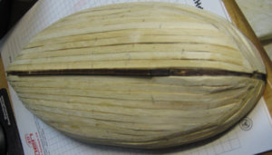

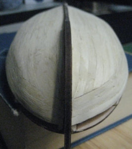

Here how the hull look after the first planking I am voluntary let show the defect to show how easy it is to correct them.
I glue the 2 stem in place front and back the fact that both end are round did make the planking of the hull more difficult
The sanding is almost finish and the hull start to look a lots better

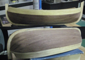

Now the hull is ready to received the second planking all the defect are gone and I have now a nice hull

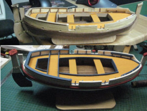

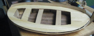

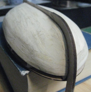

The deck planking and the installation of the first plywood side

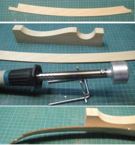

Those plywood do not bent easily so I use heat and a bending iron photo 6-3 to give them the proper bent
the final mounting the adjustment between the hull and the plywood side do not adjust nicely so a bit more wood putty and more sanding
The second planking went like a charm and did not cause me any problem
One of the only 2 modification that I did on that build is to add some planking on the inside of the deck

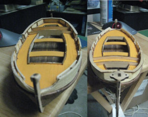

I install the rudder Usually that installation cause me some problem but not this time
I finish the deck by doing some cutting and installing some plywood part I finish those step by painting the deck a light Ochre
Now the hull is completely paint and install on his base

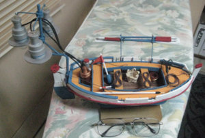

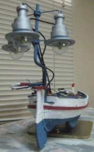

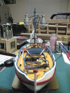

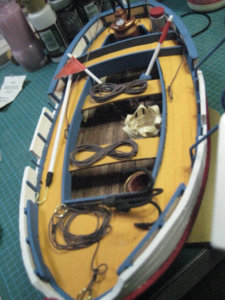

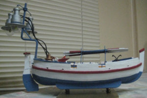

The making of all the small part went like a breeze the oar the buoy the anchor and the pall, the basket came with the kit, the propane gas tank came preformed.
The only thing that was a but touchy was the making of the lanterns as the supports consist of a thick copper wire that came in big coil, the frame is in wood ant the 2 elbow are cast metal and very fragile.
On the lantern I made my second modification as I add light bulb. The lantern itself are perform.
