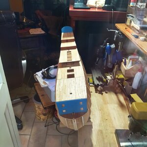

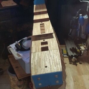

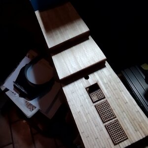

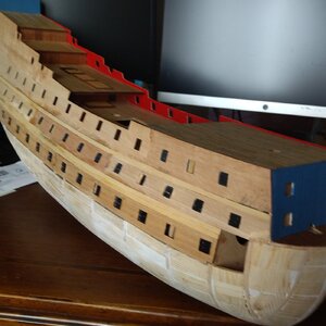

Hello, just started to build this amazing vessel in scale 1:70. DeA's kit is very well done, qualitiy materials and decorations, but it is a kit and this time I want to go beyond and build a model that when I'll look at it I can say I couldn't make it better than that.

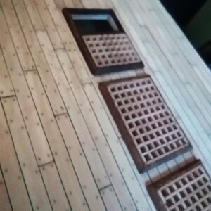

Some pics of deks not yet finished: at the end they will look teak color; also a detail of the shape of some floor boards. Hoping you will like them, every suggest coming from experts is welcome.
Update.

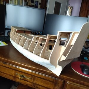

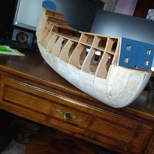

Lo scafo è pronto per la posa del fasciame. Ho rinforzato l'opera viva con blocchetti di abete tagliati a misura e sagomati. Infatti farò un solo strato di fasciame perché ho previsto di verniciarla di bianco. Resterà a vista il fasciame dell'opera morta, salvo la parte superiore delle murate che va per forza dipinta.
Even the bulwarks are done. There are still some imperfections to be corrected before mounting the final layer of planking.
However careful you are, something to fix always emerges, and it is important to notice it in time for the success of the hull. The difficulty lies in the complex shape of these hulls, with both longitudinal and vertical curves. I think that If they designed a greater number of ordinates, in order to reduce the empty spaces between one and the other, everything would be simpler.

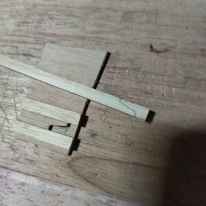

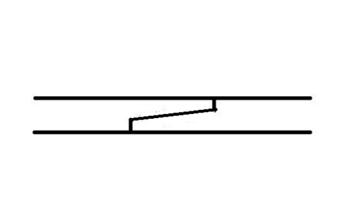

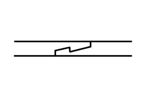

Still about joints...
I made some study in the last days and asked for informations to several modelists that are supposed to know their stuff. The result is that basicly everyone tells his story that is different from the others. My conclusion is that the only truth is there is no truth, so I will proceed with my version of truth following the way that appears to be more logic.
The basic joint is on the heads, the same as for decks. For hulls there also are two types of scull joints, simple and double.
As these kinds of joints are more stable, the logic tells me they were the ones used for hulls. Therefore I will use the double one for girdles and the simple one for the rest of the plank.
Hello Alexander, right everyone has his say.Your conclusion that you say that there is no truth, sorry have you consulted any text on the subject?
