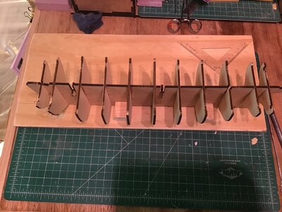

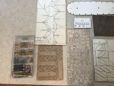

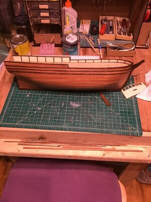

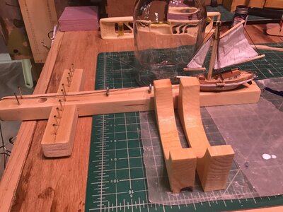

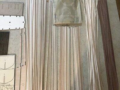

Before I begin with the Essex , I have been playing around with a ship in a bottle and here is a picture as I get ready to shove it in the bottle then onto the contents of The OcCra Essex

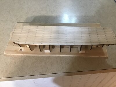

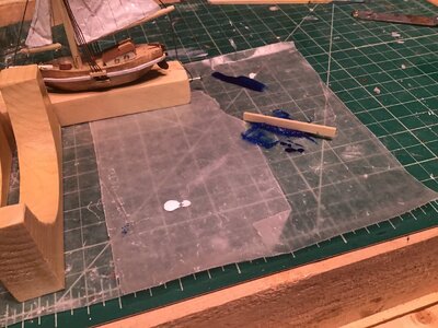

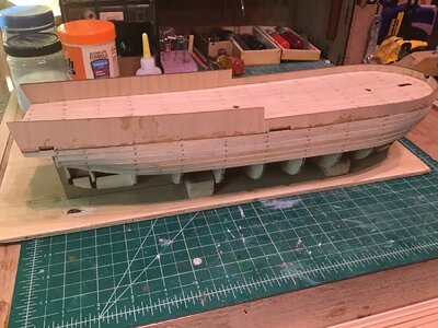

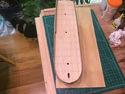

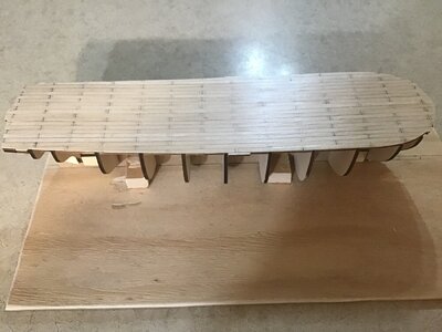

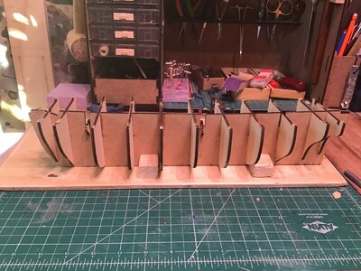

Finished with the frame and deck, now onto the rail/ gunnels and the dreaded bending of the wood. When I built the Endurance I had never used contact /cobblers cement so I opted for white glue and weighed it down overnight. This time I went with the contact cement on the deck and am very happy with it. I will use the contact cement on the second skin of the hull like I did on the last build but now I realize I don’t have to be in such a hurry.

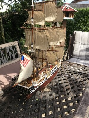

I am presently building the Essex from Ocree. The model is fully assembled and now working on the rigging including sails. This is my first build of an Ocree model and I like their instructions and the rigging diagrams seem clear and easy to use. I can post pictures when I comlete the model.

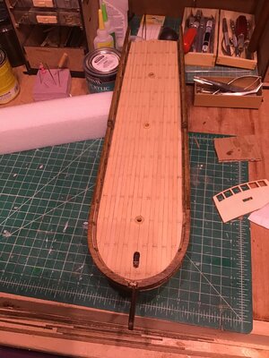

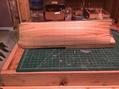

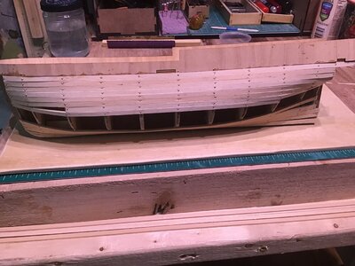

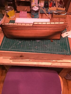

Started work on the gunnels and the hull planking. Starting from topside and working down 6 planks. Next step is to start from keel and work up what will be the same course toward the mid point of hull . For the middle coarse there will be planks cut short and angled to keep the hull lines, so it will get a little more tedious. Hopefully I can get some bench time today.

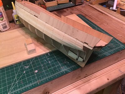

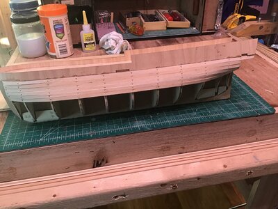

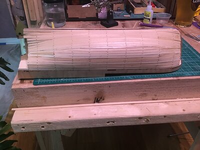

This build of the Essex whaler is by OcCre and is a good kit . The following pics are my progress on the first hull sheeting, leaving the required gaps for the next course

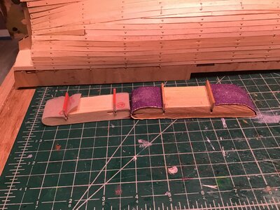

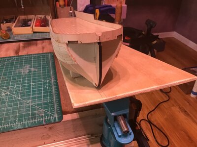

Primary hull planking done, now for a fair amount of filing and sanding. After that I will build up the bow and the stern and loads more sanding. My pin pusher finally gave out so I ordered a new one from OcCre and while I was at it I went ahead and ordered the 3 sanding blocks I have been thinking about for some time now. My homemade blocks are just not flexible enough for the lines of this hull, but still be of use in other areas. Will post more pics of progress and how the new tools are.
