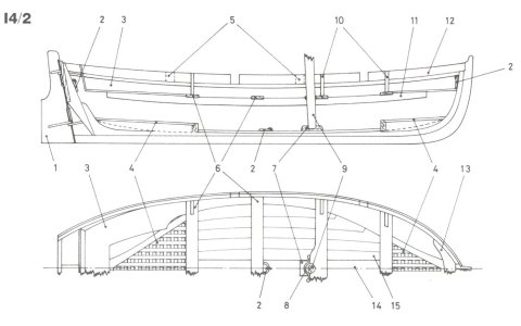

To help anyone building such a cutter, here's the layout of the floorboards and gratings. It's taken from Diana's anatomy, but they all had this layout. It's a shame it's rarely specified anywhere, so you have to guess. I'll be building the same one for my Alert in the future.
I have not seen footwaling like David White shows in his drawing on any contemporary drawings or models. Do you know of any contemporary sources that show footwaling done this way?
Thanks Serikoff!
Thanks Serikoff!
You're right, it's not the same everywhere... in fact, it's very different everywhere. I've reviewed all the anatomies I have (and there are many) and here are the options. And it's up to each individual to choose which one to use (depending on the level of detail in the specific drawings).

When I get around to building boats for Alert, I'll examine this issue in detail, because there's a major error in the Alert anatomy for the second boat. There are quite a few errors, but this one is particularly jarring. In short, an 18-foot cutter is realistic, but a 16-foot longboat is simply a scaled-down version of a larger boat, or even a larger one. Since it's simply impossible for a small boat to have eight benches, it's simply an mistake.
Having the complete set of the 'Anatomy' series of books I collated all the small boat drawings into a smart little 'book'; each of the drawings were re-sized to a common 1:48 scale.
Can't believe the publishers haven't done the same, it seems such a simple but useful thing to do.
Thanks Serikoff for posting these drawings. They are very well done but I was actually hoping for contemporary plans rather than modern day plans like in the AOTS series of books which are not always realistic as you point out. I would hope the drawings in these books are based on contemporary plans, but as you point out, they cannot be trusted without proper research to be sure. Another example of a gross error is the pinnace drawing in the AOTS book on the Pandora. They show the pinnace with a pair of tholes for every other thwart so half the thwarts are without any tholes at all so would have no rowers on those. Pinnaces were commonly, if not always, single banked and launches and long boats were usually double banked if the breadth was sufficient for two rowers on a thwart. Their drawing is neither single banked nor double banked. This mistake is not uncommon and is likely not knowing how to read contemporary drawings which sometimes show only one side in a cutaway view. This same mistake is found on many of the boat kits from Vanguard Models so the book mistake is not a lone case. Thanks again.

I totally agree that probably was the case. But, why build any boat with thwarts that could not be used to help row? I am convinced the drawings are as shown only because whoever did them did not know how to interpret the old cutaway drawings and did no research on which boats were single banked and which were double banked. In the end I may dead wrong (wouldn't be a first :)) but barring information based on contemporary sources to the contrary I do not believe pinnaces were ever configured like in the AOTS book. Another thing that might be a point of some interest, on the drawing posted in post #148, the thwarts with the support for the masts have no knees. There is no way those two thwarts would be loose thwarts. The aft one actually has hole which makes no sense, especially when the forward one is shown as was normally done.
