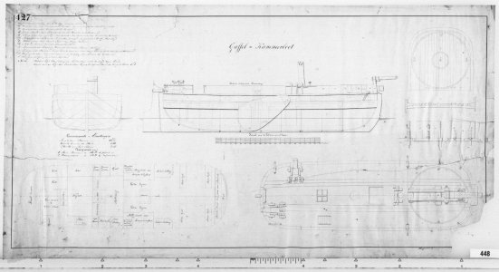

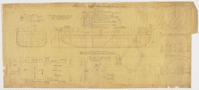

One interesting drawing that I found in the archives (Scheepvaartmuseum, Amsterdam) is dated 1831 (year of explosion) and made by
Pieter Le Comte. Its depicting the upper deck and the captains quarters of Gunboat nr.2 from Van Speijk.

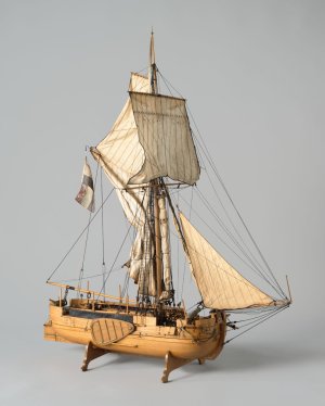

In total, at the national shipyards in Amsterdam, Rotterdam and Vlissingen and the private shipyard of J. Schouten in Dordrecht 102 sailing gunboats of this type are being built (see image, source Rijksmuseum, Amsterdam).

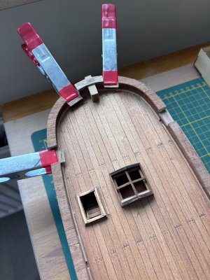

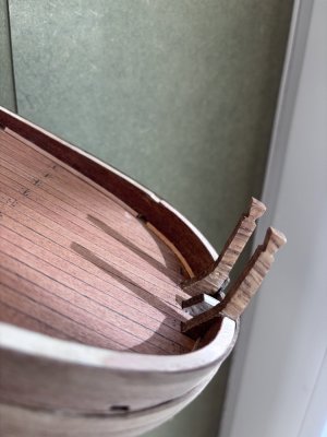

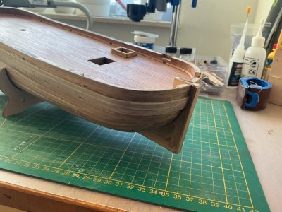

The deck was covered with slats. The two original knights made of plywood were remade from solid wood and installed.
The first part of the bulwark that was placed on deck was also veneered on the inside (better than the look of plywood). Extra attention was also paid to the scuppers for drainage.

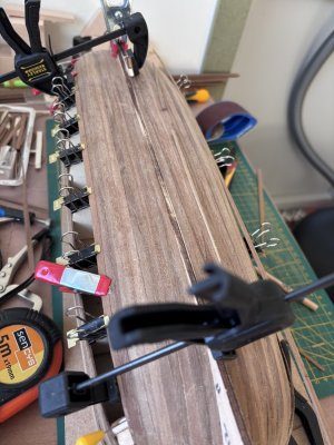

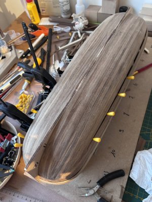

And I started planking the hull with walnut slats, and the mouldings was installed earlier than specified in the manual to make it easier to install them.

Added first change to the mantua design.

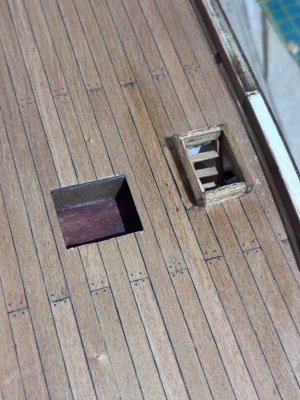

Made entrance to captain’s cabine on starboard side like in the 1834 original plans. Made also the hatch, but is not yet installed. Figuring out the hinges for that. Meanwhile continuing with the hull. Hope to finish the hull in the coming days…

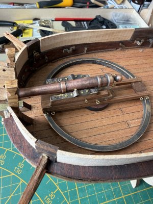

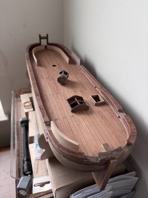

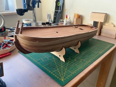

The hull of the ship is temporarily on dry land, it can be said that the planking has been done and the hull has been lacquered (transparent matte color). In the near future I will start with the fitting on the hull and the deck...

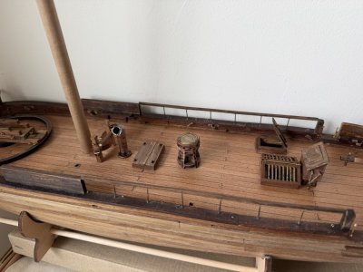

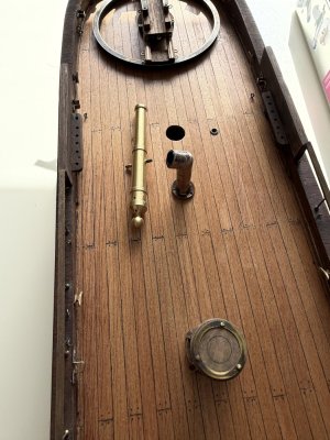

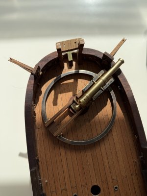

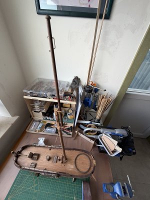

Small Progress…

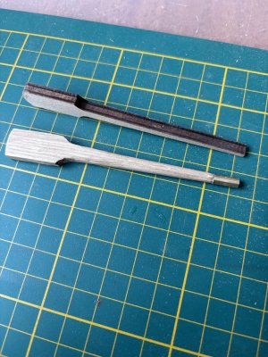

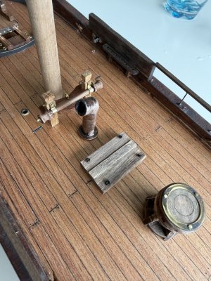

Busy with the deck and rudder, using material from other suppliers like Dry-Dock Models & Parts and Syren Ship Model Company to make the alterations….
