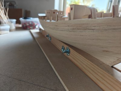

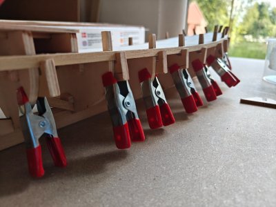

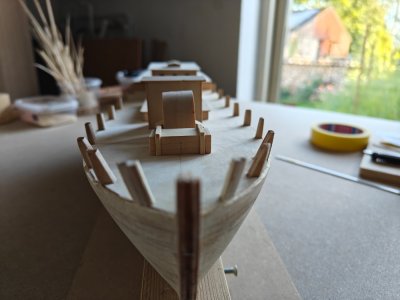

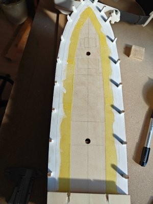

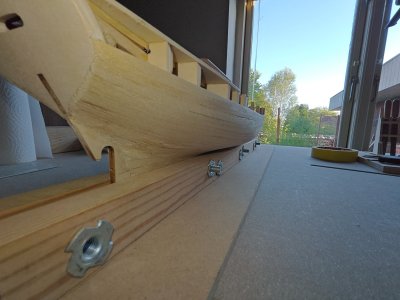

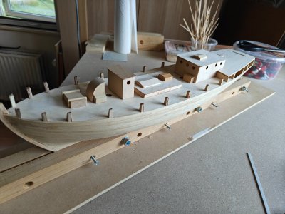

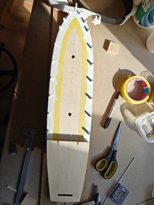

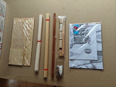

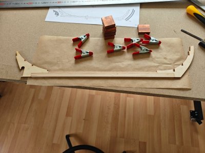

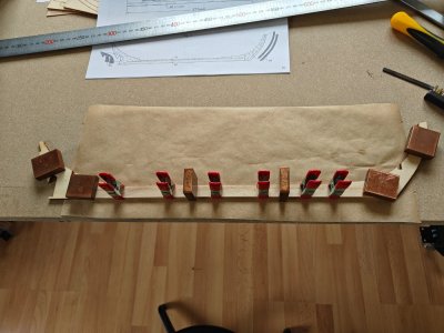

So I have started my construction of LILLA DAN from billingboats.
Some progress has already been made, I look forward to the rest of the process.
For me, it is the process to the goal, and not the goal itself, that is important
