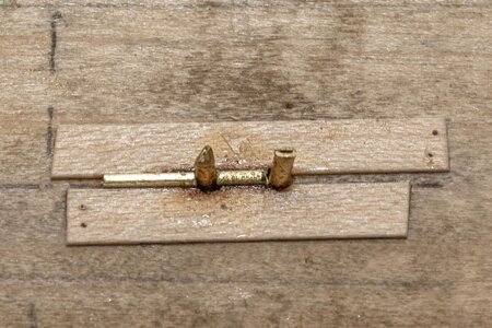

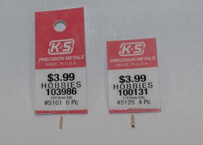

I started with some solid brass rod and tubing from the local Hobby Lobby.

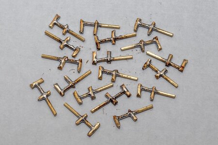

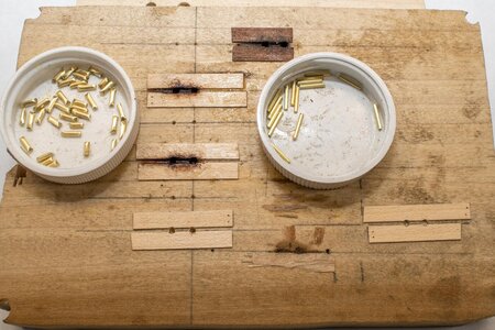

After trying several jigs the simplest worked the best. I precut all the parts before assembly. Each little jig lasted about 12 stanchions before the heat burned out the tubing holes so I made several on the same block.

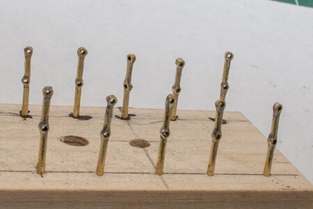

The parts are fluxed and in the jig ready for the iron.

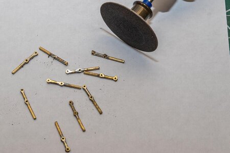

I used a Dremel to trim each piece. It has to be done slowly or the heat from the sanding will melt the solder. I found out the hard way.

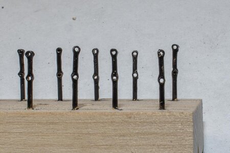

After some filing and a soak in acetone to remove the flux they are ready to paint.
Will run a small drill bit through the holes before installing on the model.

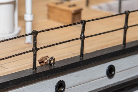

I also use third party line and blocks. Much happier with the results.
