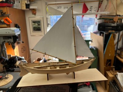

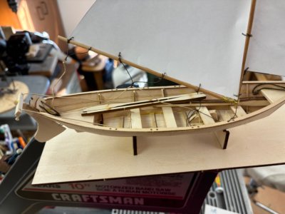

I just finished up this Dory, making the oars right now- the curved bottom is not that difficult- you just dampen the bottom, lay it between 2 small pieces of wood and place a weight on the middle and let it sit overnight. That will give you all the curve you need. Also, it will help it fit better over the frames, as whether you curve it slightly or not- it's still going to be fit to the frames.
