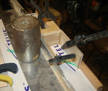

I'm getting old and my hands ain't what they used to be. I'm to the point of making bulkheads and cabins in 1:48 for my Discovery 1789. Does anyone have pictures of making these parts so I can see what building boards, clamps and jigs you use to hold them together while the glue dries? I'm assuming you would need square corner blocks and such but I'm having trouble imagining how the whole thing would work without getting in its own way. I've tried searching but search engines and I don't seem to get along.
Just in case people don't understand my gibberish. This is how I'm trying to hold together the walls of the magazine for the Discovery 1789. As you can (maybe) see I'm using all sorts of chunks and pieces. I'm just looking for a better way to do this.
I use a lot of dice as 90 degree jig blocks- cheap and easy to find and squarer than I could probably make, And wood glue does not stick well to them. Needle nose clamps help in tight spaces.

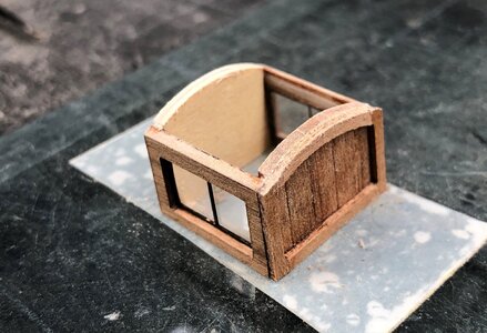

I am using often in adition double sided adhesive tape to fix the elements at the bottom
Thank you. I can imagine that DS tape could be a little aggressive. Has anyone seem sheets of Post-it Notes type adhesive?
Edit- My wife just suggested spray-on adhesive.
The tape is not aggressive ...... give it a try - a small helper
