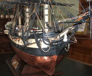

G'day Jimmy, there should be a block lashed to the end of the bumpkin, the tack from the corner of the fore sail goes through this block and is then belayed some where on the front Forecastle rail,
The block on the end of the bumpkin on my HMS Investigator, no sails so the tack rope comes down from the Sheet,
Clue and tack block that would normally be attached to the corner of the sail, goes through the blocl on the end of the
bumpkin and belays to the timber head on the front rail,

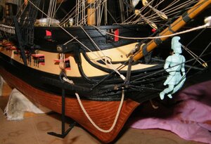

Same again here, but the rope is tied off on the inside of the bulwark, this is my HMS Surprise,
hope this helps you,
