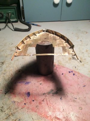

Working with brass and copper is essential if one wishes to progress to scratch-building or even kit-bashing. What the masters can do building with metal is quite intimidating, but few of us will ever go that far. Working brass and copper is not difficult with some good instruction and a few hours of practice. It's not expensive to acquire the basic tools and it will elevate your modeling to a much higher level.
See:
and
and
