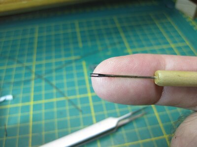

In one of the movies I saw @Andrey kudin using a needle to dose the ca. I put a drop of ca on a glass plate and dip the tool in it to use as glue stick. Works perfect. The tip of the ca container keeps fresh and the glue on the glass plate keep good for a while.
Those glue placers are excellent for small details like Syren internally strapped blocks etc.
