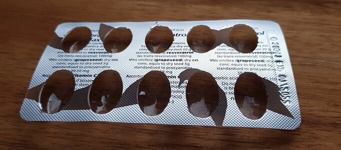

Something else that may work that I haven't used for quite a while is adding the glue to an empty tablet or capsule blister foil.
I have used these to mix small amounts of paint and hold PVA on larger models and I suppose they can be used for CA.
The best thing is that they're cheap (or free) and there's no need to clean once you're finished with each blister- once every blister is used just throw it away.

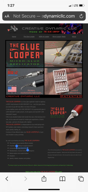

In in reference to my previous post, here is the email address for the manufacturer of glue loopers. http://www.creativedynamicllc.com/the-glue-looper.html
I have tried the tips and always had trouble getting them to work. I’ve even tried to make my own out of Q-tips, and tried sewing needles with limited success. This tool works with capillary action, Similar, but much more effective than a sewing needle concept with the top of the eye cut off. They are reasonably priced, and fit into the end of the X-Acto knife handle.
