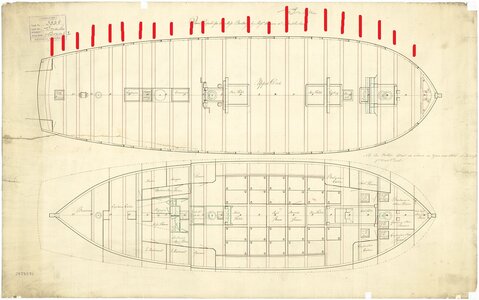

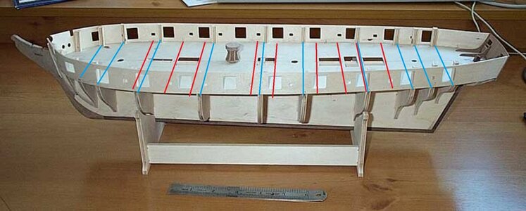

In addition to @rtwpsom2 information about the maximum length of planks (it was limited by the trees used for the planking boards) the planks should end on top of the real deck beams - also the nailing pattern of the treenails (if you make them) should be only on top of the beams.
You can see, that all the hatches and openings in the deck are between such beams
The used drawing is the available contemporary drawing of the HMS Snake, which can be downloaded from the NMM (also other drawings of the Snake)
Please do not use for the butt joints of the planks the bulkheads (blue marked) - you have to make them appr. on the real beams (red marked

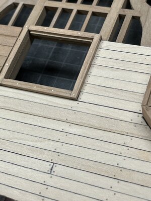

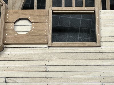

To make it it clear I add here some photos of my actual project the HMS Granado - a POF where you can also see the real beams

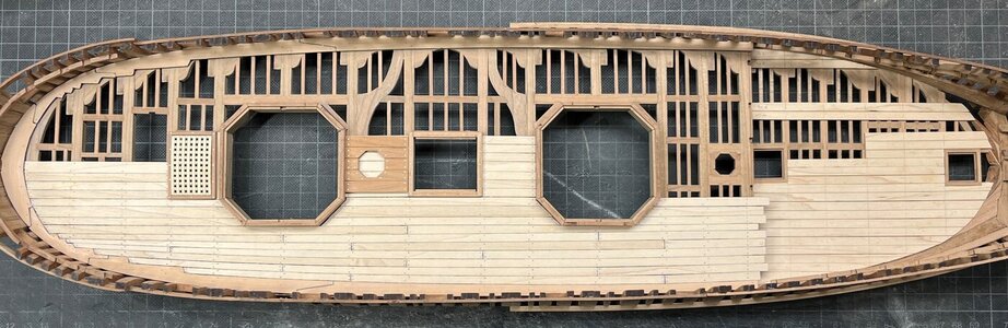

Sorry for the late reply
The scale of my Granado is 1:48
With the deck planking I followed fully the information given by Goodwin in his Anatomy book about the Granado - it is maximum the distance between 6 deck-beams
Just wanted to show you the comparison between the Goodwin deck plan an my deck planking - The pattern is follwing completely the drawing, so I followed here the Goodwin information for example the locations of joints
(Photo mirrored)
taken from post #632 of my building log
