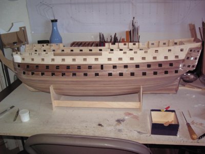

Here's a photo of my build so far...

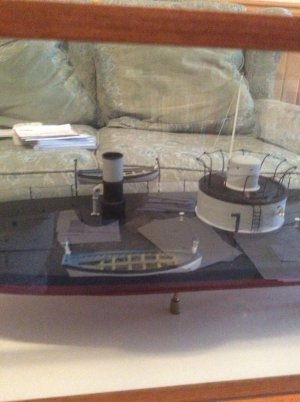

Nothing differentiates a well built model from a poorly assembled kit like ships’ boats. And they’re not lifeboats!! Each boat was a carefully designed craft, intended to perform one or more specialized jobs; from transporting high ranking officers to carrying water barrels.
These small craft can be quite difficult to model correctly as the scantlings on the real things were quite small to make the boats as light as possible. This means that if you try to plank them over bulkheads using the kit supplied materials you will have several clumsy boats displayed in a prominent area of your model.
I would instead start by carving correctly shaped plugs for each boat. If you are willing to use plastic it can be easily vacuum formed using a shop vac. Or, you can also lay up several layers of paper over the plug; each glued to the next. Frames, thwarts, etc are easily added from plastic or thick paper.
First photo: 1:96 scale vacuum formed cutters c1862

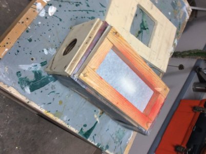

Second photo: My homemade vacuum forming setup
