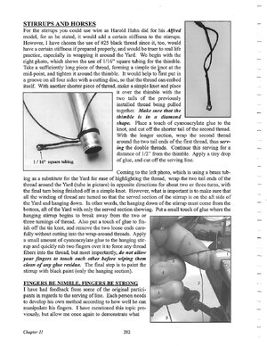

I have used 24 gage black wire. Wind it and droop it over the back of the mast. This may help: Attached is a page from Romero's Practicum of the "Warrior". VOL 5-1 Chap 11 pg 282. References are to 3/16 scale model. 0006.jpg

I'm not familiar with nrg. This page comes out of " The Illustrated Guide for Modeling HMS WARRIOR (74), 1781". Volume 5 - 1, Chapter 11, pg 282. by William Romero. There are other references in chapter 11 but pg. 282 is the actual process.
