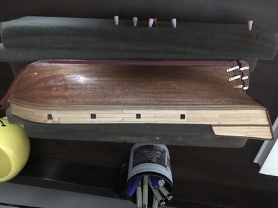

So, this is the way it turned out using Formsby tung oil. Its a horrible photo but it helps hide the faults in the planking. I like the wood look so in my eyes its not so bad that it needs to be covered up, so I will keep it this way. Blown up you can see the lousy patch job but who's really going to look that closely.
I think it would have been better if I had used a satin finish but this is what I had in my cabinet. Amazon has a low gloss formsby tung that I might have used as a third coat but then I noticed that they wanted $150 for an 8 oz bottle. Yes, you heard correctly, $150 for 8 ounces. I can get used to the gloss.
I appreciate all the tips on how to approach painting over a varnish if I were to do that but rather than experimenting on some scrap wood I am going to go on with the build. Sometimes you just want to get on to the next project. After all, the intention was to re-acquire skills before my attempt at a scratch build.
