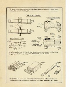

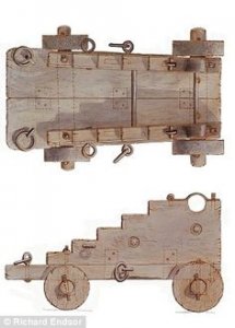

Make the gun carriage. not difficult. I have a lot of Images and drawings for that. For which deck are you talking about, as you say No carriage and dummy guns. To me, that means this gun is for the lower decks. This is normal in most kits. A dummy gunport and a dummy pipes. To lover the cost. poul erik andersen

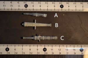

Need an inexpensive way to place 30 24pdr cannons on the gun deck of my build of Constitution.
