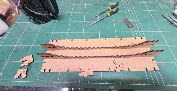

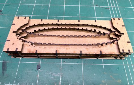

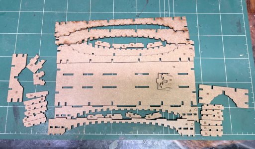

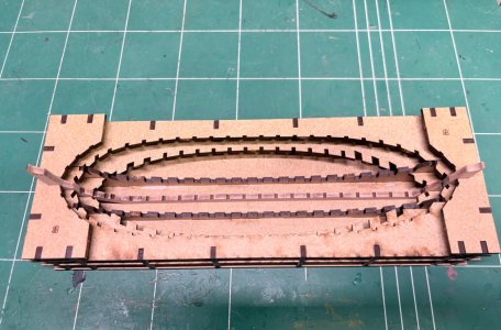

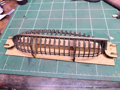

The start of the build with the first cradled and laying the keel.

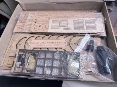

The kit: no unboxing-forgot to take pictures
The cradle:
Later with the next update : the ribs

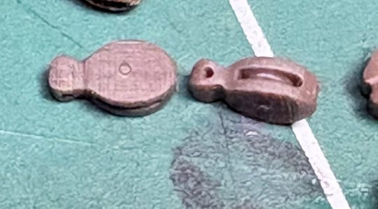

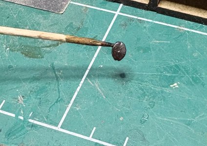

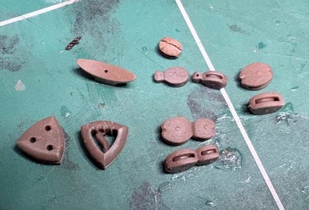

And my test on painting the blocks to look more woody.
The blocks were changed feom wooden ones to 3d printed ones :
And last question ,
Dose anyone know how those blocks called?
I consider to change the blocks but couldn't find any considerable replacement for that block.
Cheers
Guy

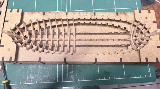

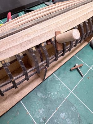

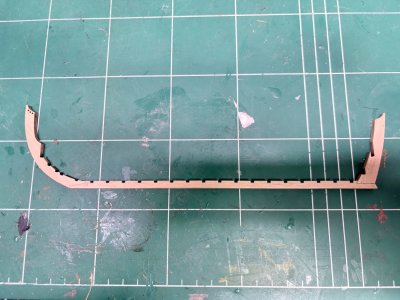

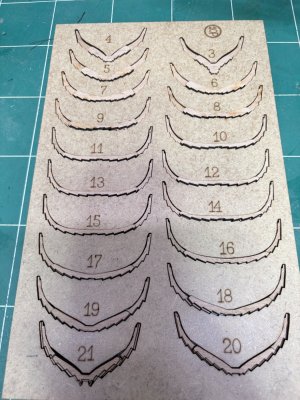

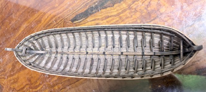

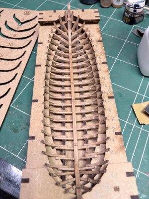

Good morning all,

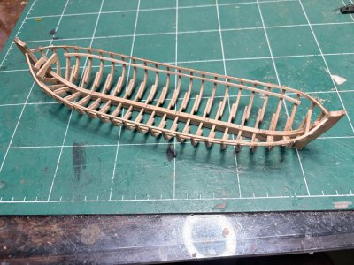

The lay of the ribs has been finished, yay,.
This kit is super gentle and need extra carful when working on it and lots of adjustments on the cradle.
And the final result after extraction from the cradle.
Enjoy and have a great weekend of relaxation
Next update : the planking
Cheers
Guy

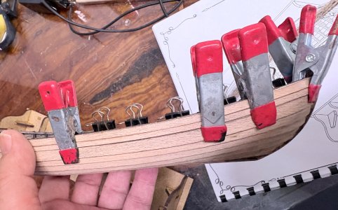

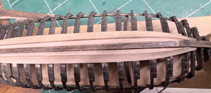

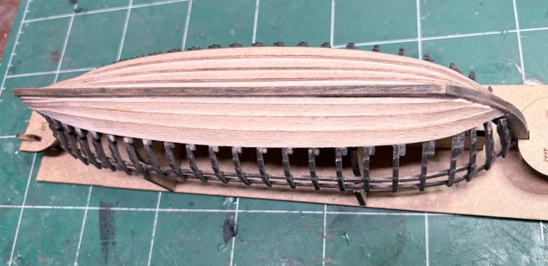

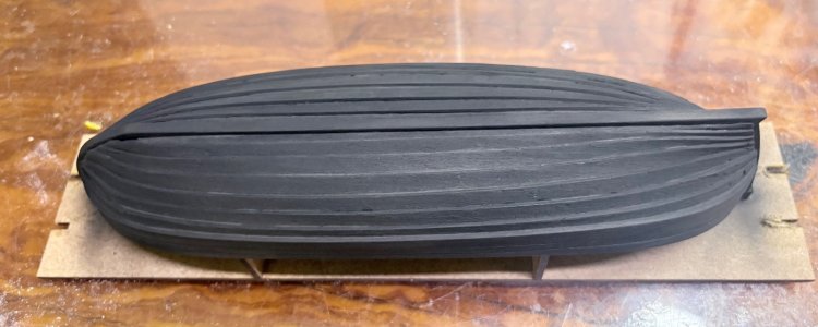

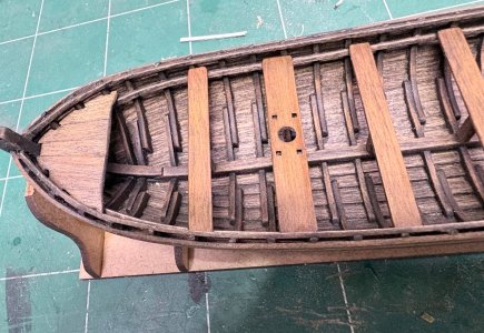

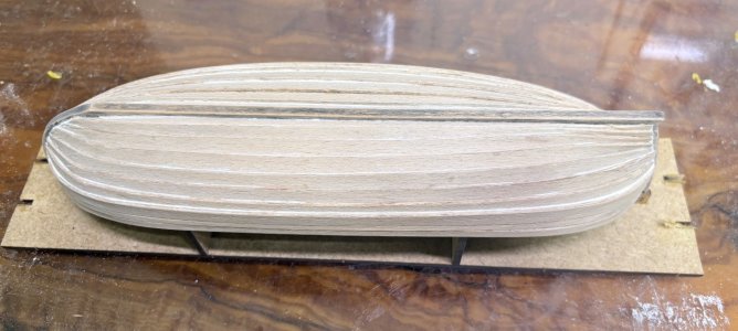

It's updated day,hooray!

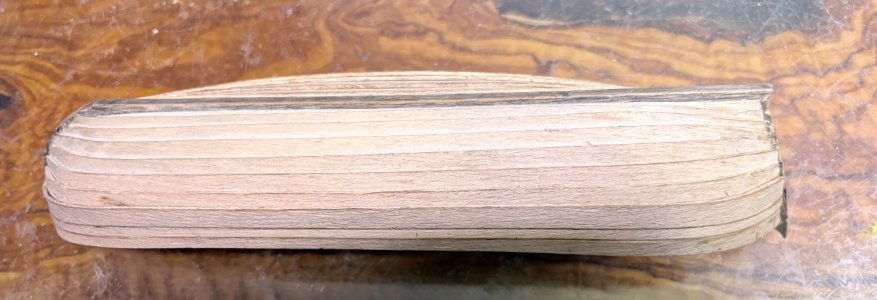

After a week or so of planking and sanding i completed the main part of the boat's hull construction.
IMG_3763.jpegIMG_3789.jpegIMG_3831.jpegIMG_3839.jpegIMG_3894.jpegIMG_3923.jpegIMG_3924.jpeg

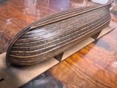

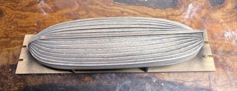

For the hull finish I decided to divert from Pavel Nikitin method of painting
I did used first his patina , but after Sanding the hull i used teak oil as finish and not diluted patina.
I love the result, i think it's looking better that way.

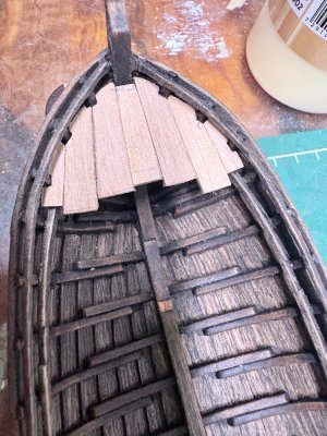

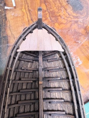

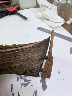

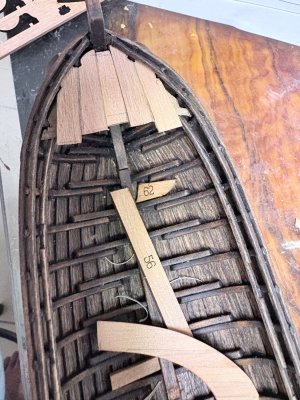

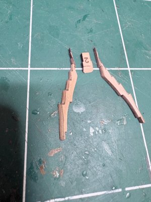

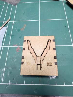

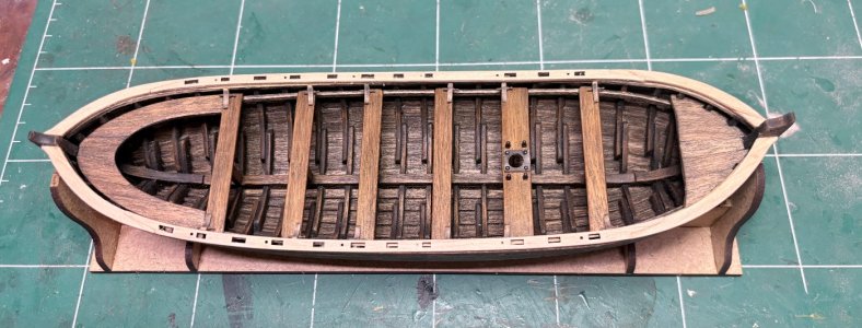

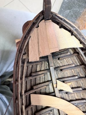

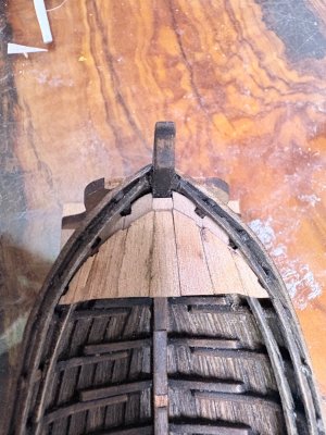

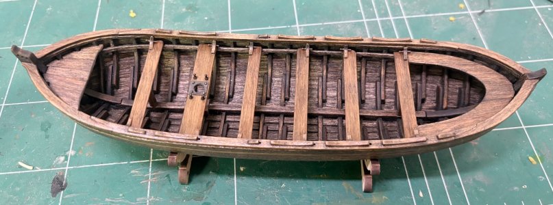

So with the finished hull of the boat I continued with the boat decks,benches,and the rudder.

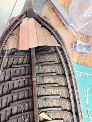

For the fore deck I did it from new oarts that i made to match the curvatures of the hull,the steam moved about 3mm forward while planking.
The original part in Comparison to my part
From here I continued with the branches and the railings

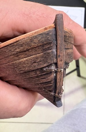

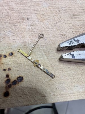

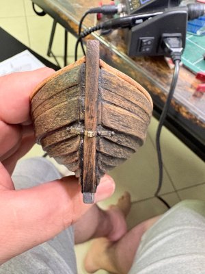

The installation of the rudder didn't turned out to the best as ir should be ,Partially my fult and partially the lack of proper parts in the kit to make hinges correctly.
From the kit part folding marks on the PE parts of the hinges will be much helpful and more important the addition of the correct tube for the pins to slide in, Any way this is the result, I think It will be less noticeable when the whole boat is completed.
Eventually it's a model for my self so I less judgmental about that.
