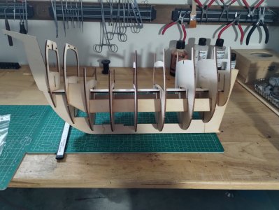

This will be my first Woody Joe Build I chose the Catalan for its history as one of the oldest sailing vessels! I reviewed the parts in the kit and the instruction manual and the and parts are very well marked and correspond to the instructions manuals although written in Japanese are not needed as the step-by-step pictures are easy to follow and understand. the quality of the parts is excellent and the frame that I am working on all parts fit correctly! The rigging line is of good quality, the only part that I see that is questionable is the rigging blocks as they are made of plastic. For the Language barrier I purchased a translator for my cell phone, and it works great! 1000000583.jpg1000000584.jpg1000000585.jpg1000000586.jpg1000000587.jpg
