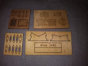

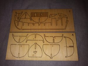

Inside the box we are presented with, surprise, some very small parts laser cut in very thin plyboard. However, for as small as they are the cuts are crisp and clean with no warping
evident in any of the ply sheets. A+ for the quality control on this scale and this cheap.

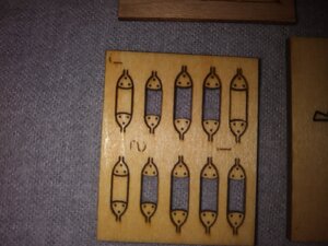

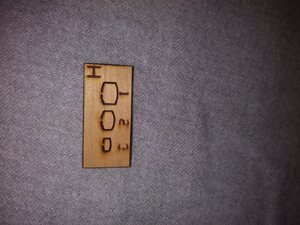

I found their attempt at the deadeyes pretty neat, we'll see how much of a pain they are to shape and rig though.

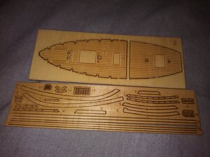

The decks of course are one peice with printed on plank detail. The thought of some basswood sheet cut into planks to
replace it has crossed my mind and will probably happen.
I was surpised to see some sort of pinrails included as well as gratings and a seperate door on the bottom sheet.

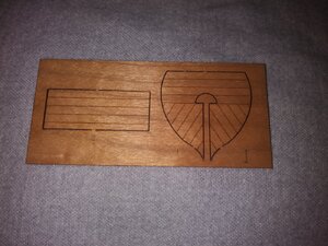

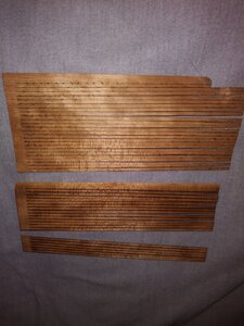

Next we have hull finishing supplies, a bunch of laser cut planks from extremely thin ply, transom/stern piece with finely laser engraved planks. No, it is not ink as I can feel each line
as I run my finger across the piece. I was really expecting much, much worse quality for such a meager price point.

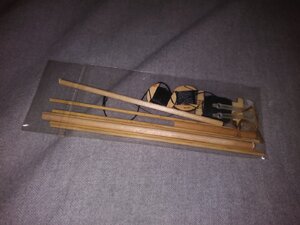

And what kit would be complete without dowling for masts and spars, rigging material in 4 sizes, and then 2 clear plastic anchors? Once painted black and the laser cut
wood parts installed they actually probably wont look too bad. Oh, and we have paper sails? I think thats what they intended.

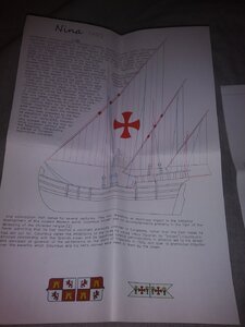

Now we have a legal size paper with a sail/rigging plan ( kind of ) and a short history of the vessel in English. Note there are 2 small flags on the bottom to cut out and paste on the ship.

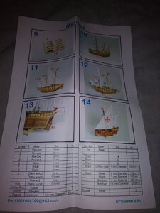

Then a one page, 14 step instruction manual, all photos with calls to each of the different sheets of ply and parts in English.

Great job on the review. I think the frames and bits are worth $20. If those deadeyes are plywood, they may not cooperate well. However, you can always supplement with other wood or some little scratch bits, and still be in a good zone price-wise.
