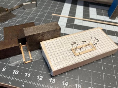

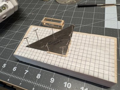

how did you cut in the slots

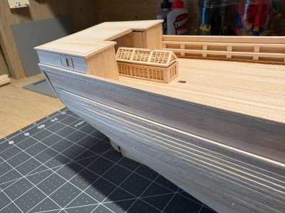

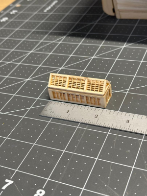

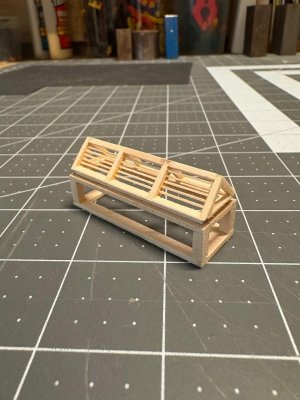

Exquisite skylight, typical of your crisply detailed workmanship on this kit build. It's a joy to behold!

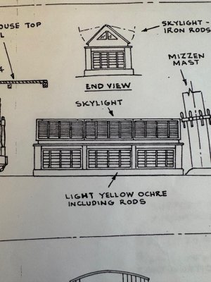

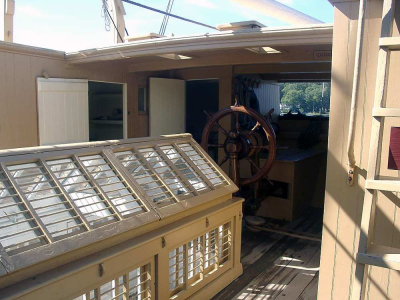

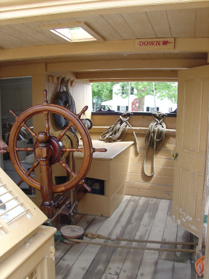

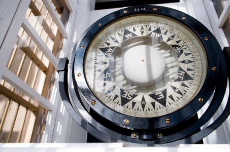

Did the MS Charles W. Morgan kit originally supply a casting for the skylight or did they expect the modeler to build it from scratch? You've certainly produced a skylight with more detail than what was provided in MS's plans! I don't see how anybody could build a skylight from the MS drawings that was an accurate rendition of the prototype. You did a good job trying to meet that challenge. There's no way anybody could have known that the metal protective bars were set in separate frames from the glass from the MS plans. See photos of the prototype below. I have found similar issues with the 1939 plans, drawn a couple of years prior to her transfer to Mystic Seaport's ownership, and revised in 1957, by Marine Models Co. Mystic Seaport's plans library offers copies from a set of Morgan plans drawn more recently at a substantial price. Mystic's library has construction drawings of the skylight done in 1981. See: http://mobius.mysticseaport.org/detail.php?module=objects&type=related&kv=331331
