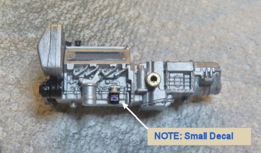

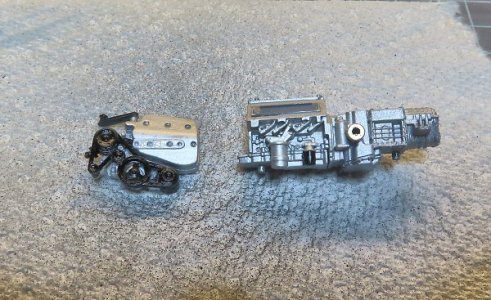

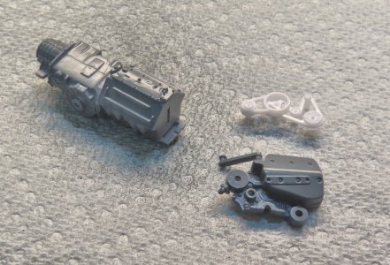

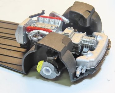

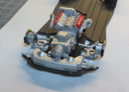

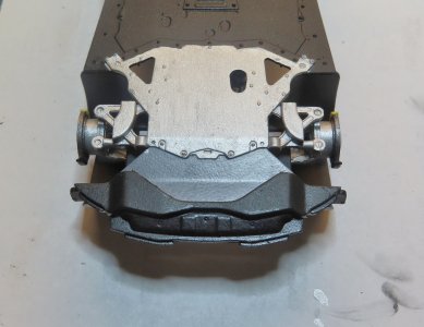

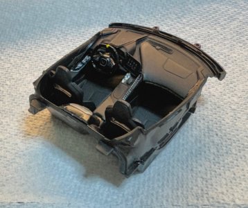

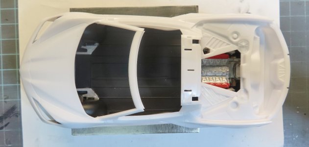

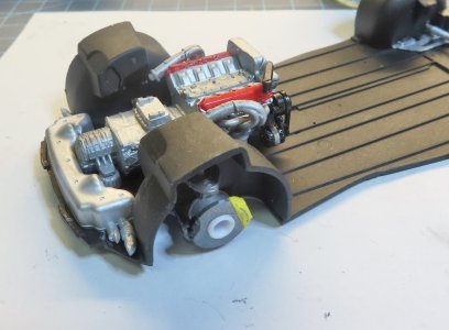

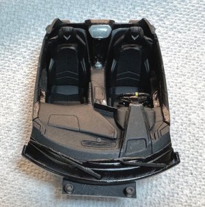

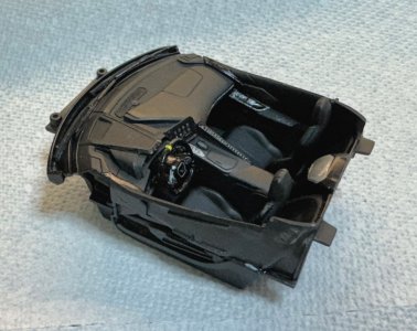

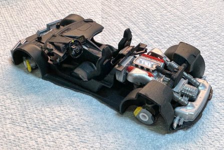

I am currently building the 2022 Chevrolet Stingray Coupe. I will add some pics as I go along. I am thinking that this build is not going to be a step-by-step process, but rather an "in process" type of build, so some "glue-ups" and steps might not be shown to reduce the amount of post.

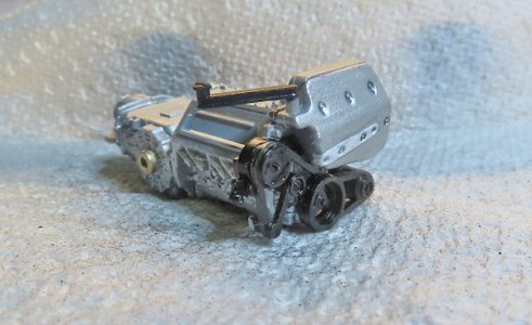

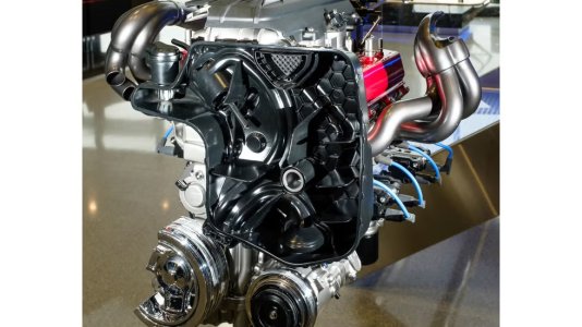

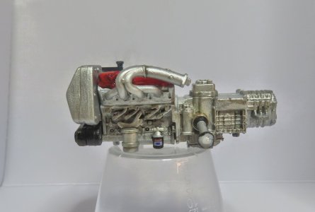

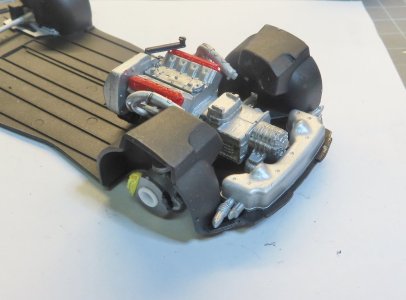

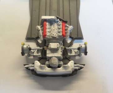

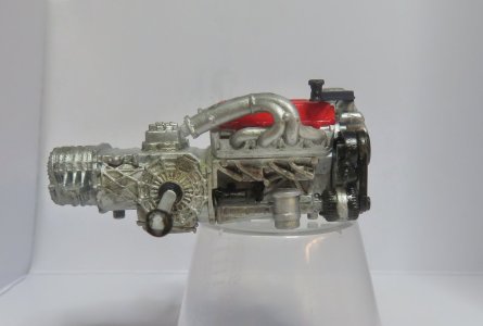

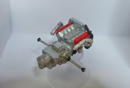

So, I guess that big silver thingy on the engine with the, what looks like an oil filler cap on an arm is part of the dry-sump oil system for new Corvettes? :p
Yes Jim, you are correct. Actually a little embarrassed as I have not focused much attention to the engine as much as I should. I have had all my attention to the body interior and exterior.
Now that you brought that to my attention, I have read more about it. They have two oil chambers, one that is a constant feeding circulating for mechanical aspects and then the dry sump which stores the oil in that strange looking vertical pan thing in the front.
Here is a cut-a-way of the front oil structure. Quite amazing. Because the car has the race track Grand Prix class, and pulling a lot of “G’s”, the oil has to be circulated in a different manner than regular passenger cars.

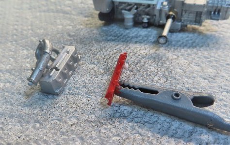

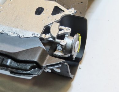

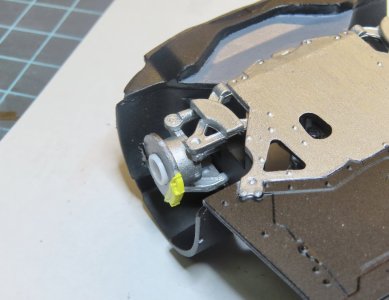

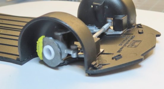

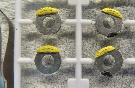

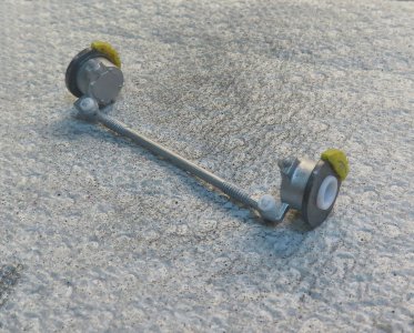

Now, the brake calipers. These decals have got to be the tiniest I have ever seen in my life. It is almost at the law of diminishing returns of who can see them unless you get the car very close, but they are there, and I know they are there. A pair of tweezers off to the side to give relationships.

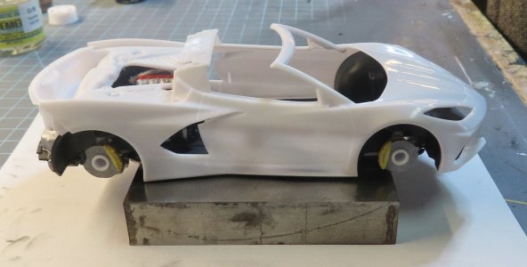

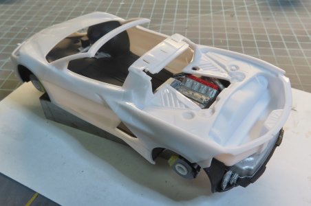

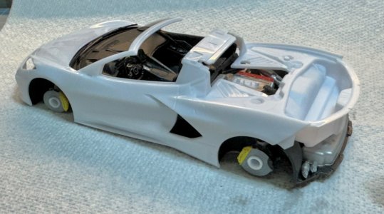

The main body will be painted the same color, which should represent "Competition Yellow" from the 2025 factory.
