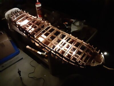

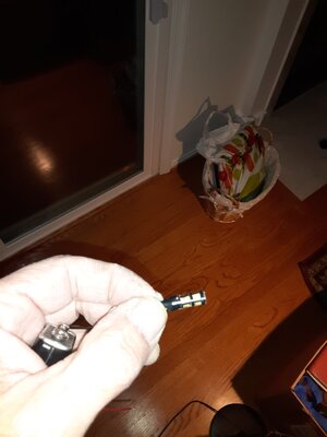

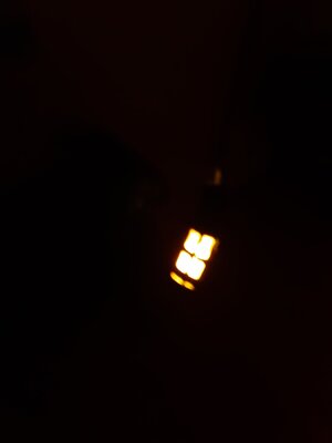

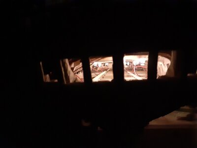

I dont know if it applies to your model or not, but I built an LED network for my large President that really lights it up. Trn LEDs did the trick. Uses a 9V source. Connection was via varnished copper wire from the craft store, plus I made little lanterns out of soda straws.20201223_232540.jpg20201228_211259.jpg20201220_191835.jpg20201220_192118.jpg

The lighting in that model looks pretty amazing. I was planning on using LED strip lighting in the hull, for starters. Where do you source your lighting products from?
I just go on ebay where they sell sets of ten mini LED lamps. Then you just solder them up with copper wire, in parallel (if I remember how i did it). I can draw you a picture, if it would help, when I have some time. The lamps are a bit overdriven at 9 volts, so I ordered an ac adapter for a lower voltage. The lamps are hardy, but this will guarantee very long life. There are only 10 lamps but they look fantastic. The pictures don't do the setup justice.
How long is your model? Ten LEDs should do the trick for sure.
She's a big lady; 1.4 m long, with hundreds of portholes of varying sizes. :)
