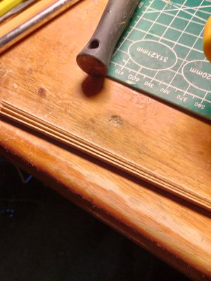

I've started group sanding the planks to reduce the variance in width. Helps somewhat.IMG20250322093219.jpg
I can see that makes sense, but may I suggest that you make up a u shaped jig to allow you some precision in the width of the finished planks, and at the same time ensure a 90 degree corner so that planks butt up to each other tightly?
If you are using abrasive, rather than, say, a block plane, then something like a couple of brass strips, one each side of a ¾ inch spacer would allow you to line up the top surfaces, and using opposing wedges in the gulley to tighten the planks up, you would be batch producing identical planking with good corners.
At a single plank level, then a saw kerf would provide a jig for holding a single plank. Lots of scope for creative clamping in this topic.
J
Thank you, tim looking in what little stock I have to make something up

90 degree corner
Sorry to ask, I am not sure if you are you speaking about the butt or the long edge? Can you post a sketch or photo? With the taper in breadth that is pretty much equal for many strakes, especially below the main wales, a jig sounds like an interesting idea.
Thanks Jim
