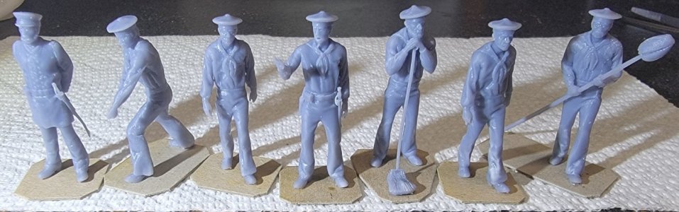

Don't have paint for hair and stuff yet, but I did have more figures to paint, as much as I could, so...

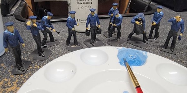

Dark blue and light blue, next is white pants
Here's about as far as I can get. Let 'em dry and do a little touch-up. The new colors are due tomorrow and they'll all get haircuts and their beards trimmed.

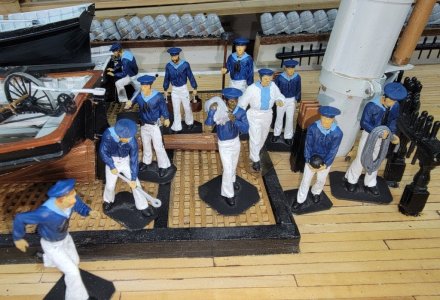

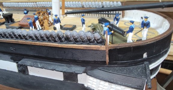

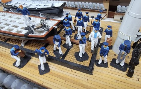

For now they join the other fellas on board

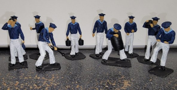

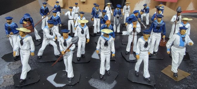

All the crew are painted, at least till I print more ;)
I think I found a good shade of brown for my Black crewman; all these fellas should look like they've been out in the sun for a while, even him.
There's some little things to touch-up, but they're pretty much done.
Ivan got a new shirt/jumper; does it make him look fat?

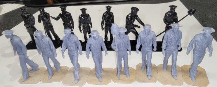

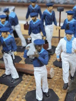

A few thunderstorms have blown through, knocking out power for a few minutes several times, but in between I managed to modify three of the sailors.
Two of the walking fellas I put straw hats on, and the rammer guy got a sponge and a different head, so he's a match for the rammer guy.
While working on that I had a batch of the existing figures printing. I had 11 of them on the plate, but only 7 came out.
They're primed and painting them will get started if the primer dries in this humidity. The three modded guys are just about done printing now.

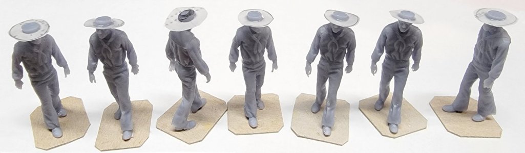

I watched a few Blender videos and think I get how to repose a figure. I have one that looks like he's pushing a capstan bar that I hope to be able to repose in several positions like climbing, sitting, and so on.

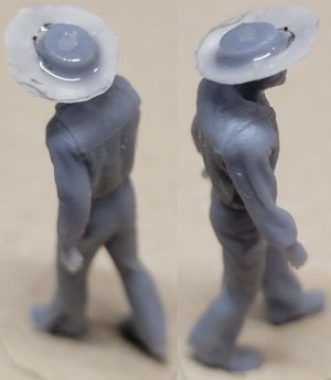

After priming the Magnificent Seven, the next batch consisting of the figures I modified, came off the printer. I apparently made the straw hat brims too thin and they didn't survive the printing process, but everyone came out otherwise.
I thickened the hat brims in the file, and set about repairing these fellas.
I cut out hat brims from used 20lb paper, made a hole for the crown with a hole-punch, painted it with resin from the printer, and zapped it quick with UV light. I brushed on more resin to fill any holes, zapping it between applications, and being careful not to zap for too long or the heat generated might burn the part.

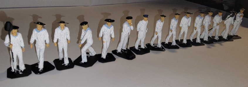

Painting commences on the second batch of crew, who will all have white jumpers....

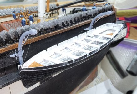

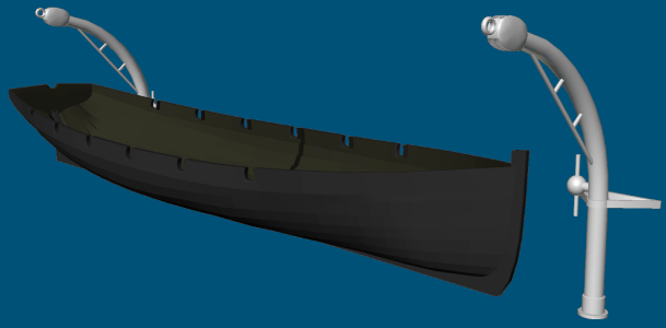

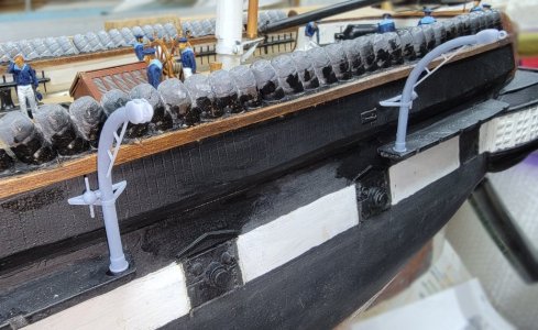

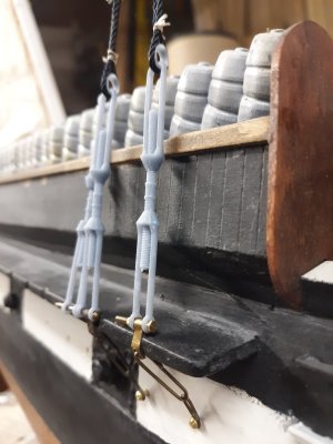

I fiddled with the poorly printed davit and some chipboard to figure out a brace to the bulwark. I figure there had to be something, and that it would bolt to the hammock irons inside the bulwark. I reworked the 3D model to add the brace, finalize the double block at the top, and add watch I think was most likely a ring rather than a ball or acorn. A pair is on the printer and has 3 hours to go.
It took longer than 4 hours because the printer spent 2 hours doing nothing until I checked on it and restarted it.
So here they are stuck on to check the fit, and it looks pretty good to me, even with a boat hanging in it. When they get installed for keeps, I put a brass pin in the base and through the channel.

The crew got some touch up, and I tried a "wash" on them which wasn't all I hoped it would be., I kept it anyway, and gave them a couple of coats of clear-coat.
I think Ivan's been sneaking extra hard-tack, he really looking a bit tubby.

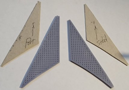

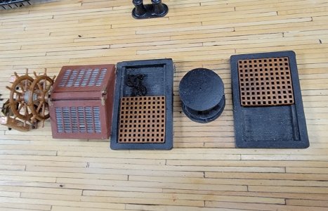

I made a pattern for the head gratings from chip-board, scanned it and used the image to make 3D models. Went away for the weekend, and printed them when I got home.
I need to install cleats (like seat cleats in a boat) for them to sit on along the spray-screens and hull. Then I can more accurately see how the shape may need adjusting, which may mean printing again, which didn't use much resin, but did take 4 hours.
The crew got some touch up, and I tried a "wash" on them which wasn't all I hoped it would be, but I kept it and gave the a couple of coats of clear-coat.
I think Ivan's been sneaking extra hark-tack, he looking a bit tubby.

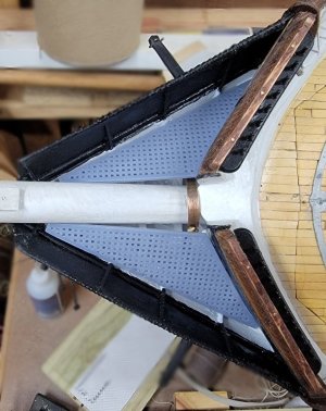

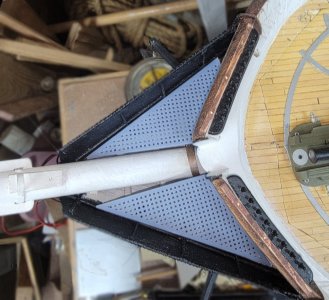

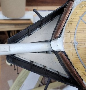

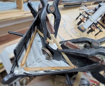

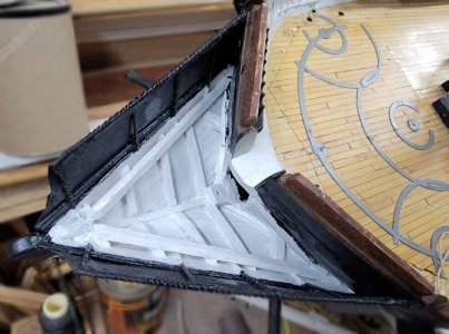

I installed cleats and ledgers for the gratings to sit on, The ledgers were dipped in ammonia and clamped over-night to take the curve of the hull, then glued on.
I fit new card templates in, then painted inside the head.

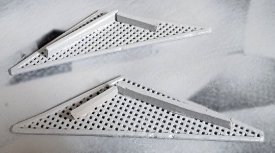

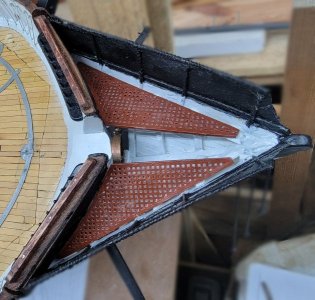

I remodeled the grating using a scan of the new template, but I loaded the scan into the existing reference image that had a different aspect-ratio, simply put, the image was a little distorted and the grating were wrong, which I didn't pick up on till they were printed.
I changed the reference image and remodeled the gratings yet again, arranged them for printing differently so they only took 2 hours, instead of 4 to print, and finally they came out right.
The port ledger board is angled wrong, so needs to be removed and reset, but otherwise I think it will do. Resin this thin will want to warp, so I may glue a beam to the underside, parallel to the bowsprit to prevent that. I though of using rare-earth magnets to hold the gratings in place, but the tuck under the bowsprit, forward, so I'll put the seats against the hull, 2 or 3 on either side of the bowsprit. The aft end of the gratings will slip under the seats and should secure enough.
Meanwhile I primed and painted the gratings, then painted them again in a color more oak-like..

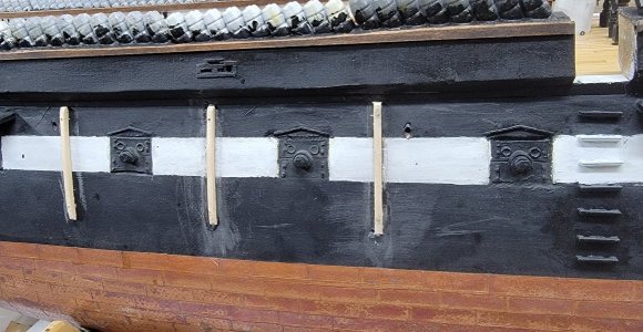

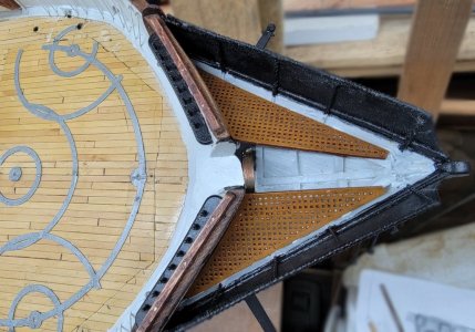

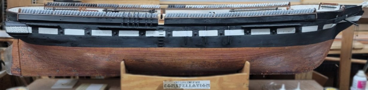

Finally getting back to the rub-rails, I reexamined every painting and photo I have, starting with the 1856 portrait. I can confirm there were rub-rails (aligned with the main hatch) between gunports 6 & 7 (counting from aft), 7 & 8, and 8 & 9. There were more added aft, probably when the additional boats and tall davits were added, but only these three are consistent in every image.
So, that's all I'm doing. If I someday confirm there were others there in 1856, I can add them easily enough.
I made a template of the shape of the hull-side where they attach, and cut them individually on the band-saw from the spruce board; I didn't want to spring straight pieces onto the hull-side. They were clear-coated as a sealer, CAed onto the hull and any small gaps filled with fine sawdust and CA. They were drilled and pinned with 1/16" bass rod. A little filling,a little sanding, a spritz of clear-coat, and they got black and white paint. Then I turned the hull and did the same to the starboard side.
con20250729a.jpg port side
con20250731a.jpg starboard side
con20250731c.jpg starboard side freshly painted
8/5: At a point before the chainplates are finally installed, the hull will get masked and a nice neat paint-job done, till then, it'll look a bit slovenly.

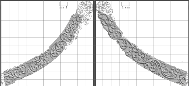

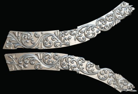

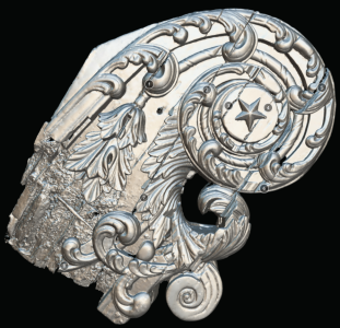

In the Macedonian build-log I mentioned trying to get a scan-file of her figurehead, and finding images of it on SketchFab. While going to confirm the images were still there, I noticed a "billet-head" file listed and since it looked familiar, checked it out. It actually was a scan of Constellation's billet, and with a little more looking, I found scans of the trail-boards as well. Like Macedonian's figurehead, these parts are deteriorating, so were removed and scanned in order to produce replicas to be put on the ship, while the originals are conserved.

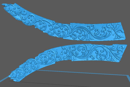

The files weren't available, so I took the best screen-shots I could manage and used those at SCULPTOK to generate STLs.
I loaded the STL into Blender and used it's Decimate feature to reduce the number of faces and make the file manageable, which I saved as an OBJ I could import into Anim8or to clean-up and manipulate to fit the model.
There's a lot of tedious work to do yet, but I think I may have Constellation's head ornamentation finally figured out.

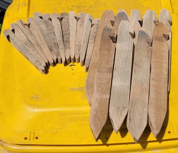

Nearly 50 years later, I participate vicariously by making tent-pegs for the 2nd Virginia, Continental Regulars.
(some, of the 46 oak tent pegs made today, broken band-saw blade not shown)
but I did some work in the shop ;)
