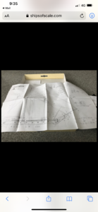

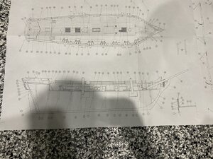

all I have is what I have attached. It doesn’t give me the size from how far I do them :( or am I just lost lol
The bulwarks run from the bow to the end of the poop deck about 600mm.The second column in your book give you the approximate length. The inner bulwarks are about 460mm. If I remember right it takes four planks on top of each other to complete the outer bulwarks build up.

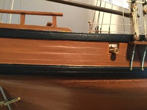

A quick view of mine.
Neptune is correct on how the you need to cut out the scuppers, one bulwark plank winds up to be the bottom, the next plank winds up to the upper portion of the scuppers.
The instruction booklet is vague on many steps and you can’t scale horizontal distances from the plans since they are 2D and you’re working in 3D. I used a piece of copper wire (12 gauge), bent to the outside shape of the deck to approximate the curve and length of the planks for the bulwarks.
