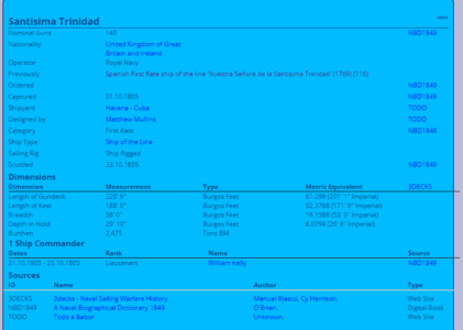

Does anyone know the precise conversion rate of a Spanish Burgos Foot to either a meter or an English/Imperial foot? I have searched the web diligently and cannot find mention of what Burgos Feet are (presumably a measure developed in Burgos, Spain)? If it is another name for Spanish Pie, then I get 1 Burgos Foot is 10.91 inches but this is just guessing! Links also appreciated so I can understand what it truly means.
just a quick check at Three decks -
Maybe you can recalculate based on this comparison
Please check also other spanish ships on this page, not that there was a miscalculation directly on the Santisima
