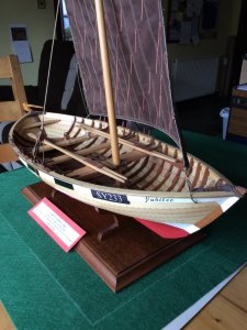

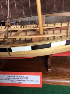

Bonjour Donald,
Magnifique travail! and this is the kind of scale I enjoy because you can do details which are functional...but in my case, I'm afraid it's also link to my incapability to work on too small things...perhaps with some training....when I get time....retired....
Whatever, may I ask you some details on the technique you used to make this rivets and roves? Did you "punched" them with a ball hammer and contre-poids or with an adapted pliers?
Merci d'avance for your advises!
Bob
