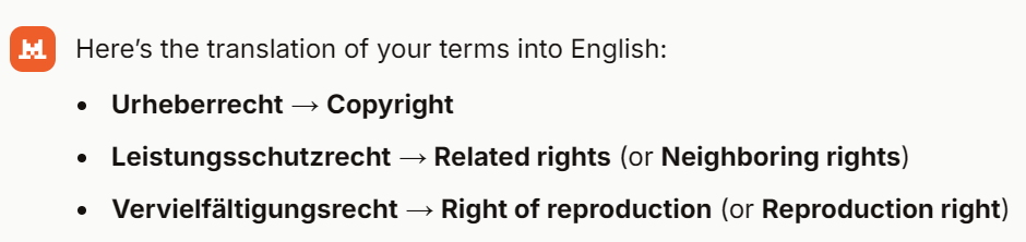

From a legal point of view, these old plans are not treated as designs that could potentially be protected by patents, but are treated like any other works of a general graphic nature, such as artistic paintings, sketches, photographs etc. (for this reason, no specific technical features of the design presented in them are relevant when assessing possible copyright infringements). As a result, possible copyright infringements of these plans are considered on exactly the same basis as any other graphic work of an artistic nature.
The original content of these plans cannot be protected by copyright, if only because of the passage of time, and in most, if not all, countries such protection is limited by law to a few decades. In contrast, later images of these original plans, made by photographing, scanning, redrawing, etc., are subject to copyright protection.
In conclusion, if you redraw such an old plan (even on the basis of a legally protected copy), especially with the graphic modifications you indicate, not only will you not infringe anyone's rights, but your creation will also be protected by law.
There is also the question of commercial or non-commercial public reproduction of modern copies with valid legal protection, but in your specific scenario this is irrelevant.
