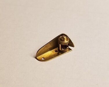

I'm in the middle of building the Corel Flying Fish. I'm starting to install the deck furnishings and can't seem to figure out what this part is for. The highly concise (sarcastically intended) Corel directions and drawings do not show or reference what this is or where it installs. Thanks for any assistance in identifying.Unknown part.jpg
I'm in the middle of building the Corel Flying Fish. I'm starting to install the deck furnishings and can't seem to figure out what this part is for. The highly concise (sarcastically intended) Corel directions and drawings do not show or reference what this is or where it installs. Thanks for any assistance in identifying.View attachment 204209
G'day mate, there should be two of them, one should have a green light in it and the other a red light light, they go on each side of the ship, you might also have some ones to go up on the mast if there is one they will be clear lights, they are used to show other ships which way you are going, hope this helps,
this is a pic of the where they go just above the X, this is obviously the starboard side one an d it should be green,
best regards John.

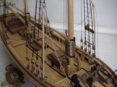

Hello, Dslongman!
The part you showed is one of the navigation lights. Consider the 2 mounting holes, it is a port-side navigation light (mounted on the left, and it should be Red. The Green navigation light always mounted on the starboard side.
Hi dsgoldman1!

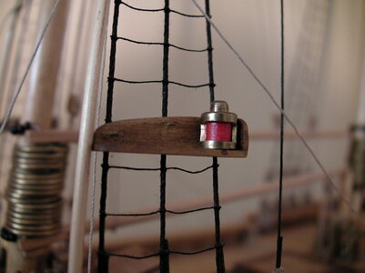

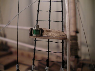

I did not like the brass version and it was replicated from wood.
Navigation light starboard.
Navigation light port side.
In the lamp housing is a painted wooden rod as a glass imitation. The navigation lights are attached to the shrouds with thin thread and the holes are sealed with wood kit. Thus, the attachement is almost invisible.
With best regards
Thomas

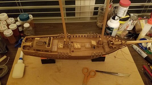

Hallo @dsgoldman1
How is your work on the Flying Fish going ?
Remember the old sailor's saying: " Red Right Return" which reminded them if they saw a red light on a ship on the right side as they could see it, they knew the ship was coming at them. (Airplanes too!)
Thanks for the birthday well wishes. Here's the progress on the Flying Fish...heading toward rigging

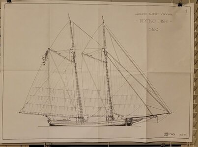

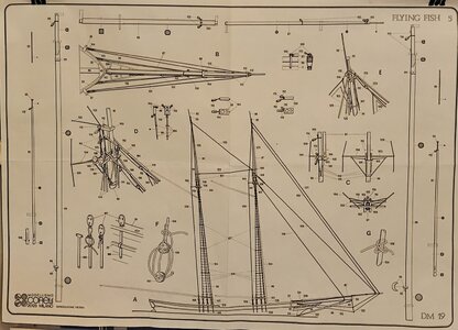

Hi dsgoldman, I built this 20 years ago and have lost the plans. I need to repair the rigging, could I ask if you would be prepared to photograph the rigging diagrams and forward to me? Would be much appreciated Regards Tony
Many thanks Dale, please include the anchor rig too. Have you completed your model? Once I get this fixed I'll return to Corel's HMS Unicorn :) Regards
Tony
Tony,
Hopefully these are clear enough for you to use

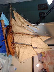

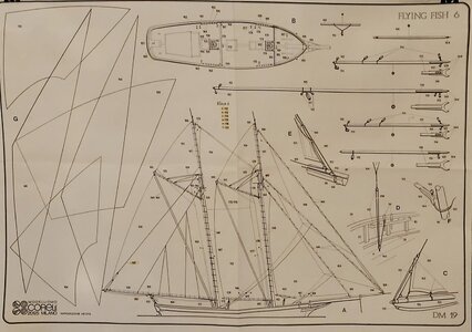

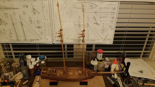

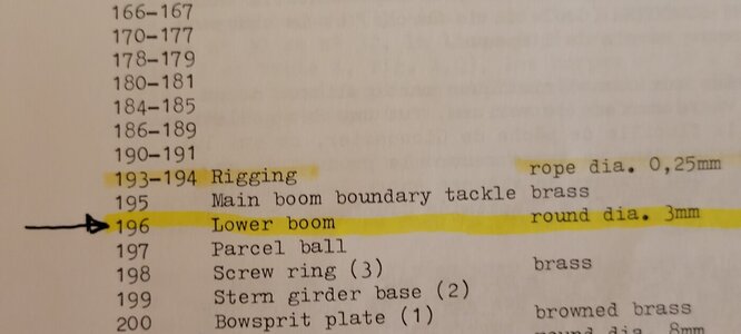

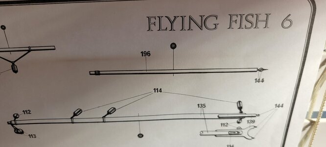

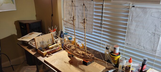

Now that I am well into the rigging of Corels Flying Fish, I still cannot for the life of me locate where the lower boom (196) goes on this build. Probably right in front of my eyes, just like the original post. Any thoughts
Tony Law, you survived this mess, where does the lower boom go?
Thanks
Dale
Thanks
Dale
Hi Dale,
Happy New year! :)
Your build looks great!
I just looked all over my model and I cannot see that part anywhere. I ran though those I can see you have installed and compared to mine. They are exactly as I have mine, no extras! So either I didn't have that component or I couldn't find a place for it either, its too long ago! Suggest you proceed with the sails and you may find it that way but I wouldn't hold my breath.

Tony,
Thanks for the timely response. I'm not surprised, I've had to weed my way through the poor Corel drawings and directions. So, its amazing I've gotten where I am. Not sure it's all correct, but hopefully close enough. I've pretty much got all the rigging lines in place, the rat lines are built, but not installed since they will be in the way of trying to install the sails. I'm debating whether to install the sails or not. We'll see
Happy new year
Regards
Dale

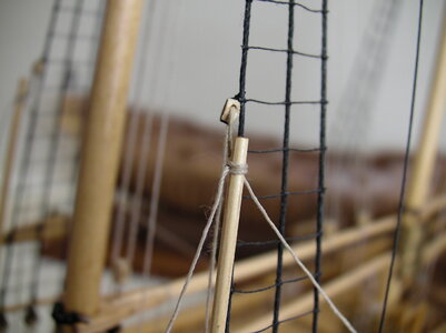

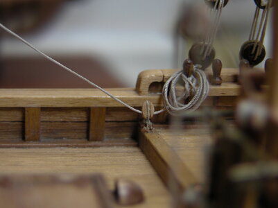

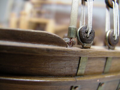

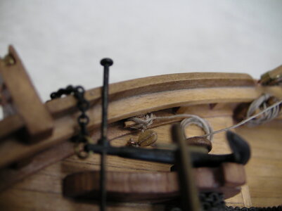

Hi Dale!
The lower booms (196) can only be seen on the kit cover image.
I had mounted them once for this out of interest.
Upper end of a lower boom.
Hinge on the ship`s side.
Rope attachment at the bow. . .
. . . and amidship.
The function of the lower booms was once explained to me as follows: they are lowered and the Dories can dock on them without hitting the ship's side.
