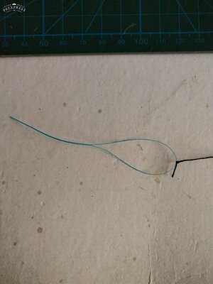

Just wanted to add my two cents worth... if needle threader doesn't work, I usually go to my trusty old dental floss. Usually the knot at the tip is small enough to get through small holes.PSX_20201102_131428.jpg
