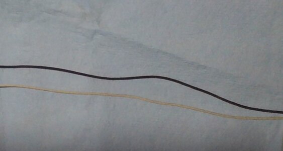

I tried poly and found it had a shine to it and was hard to tie knots. I make my own rope with cotton Aurifil brand and I think it looks very good.
Thanks for the reply. Do you have images for self-made rope, just to have an idea of how does it look? That would be great.
That's exactly what I meant. It looks a lot more natural to my taste. I also get my material from a small factory in Germany, where it is made by hand. Certainly I couldn't do better.
