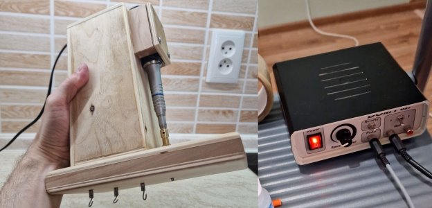

I discuss the theory of what ropes and cords are, their differences, and their purposes, and I share the production of a rope-making machine of my own design. Perhaps it will serve as a basis for someone in creating their own.
As I fill in the information, I will add links to specific messages here for easy reference. The next topic I plan to cover is mistakes and life hacks in rope production.
>>> Ropemaker and theory <<<

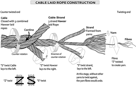

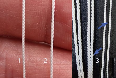

In this post, I want to touch on the topic of mistakes and life hacks when making ropes and cables.
In the article linked, I discuss in detail:
1. Lint—why it's bad and how to get rid of it.
2. Twisting strength—how to twist ropes correctly.
3. Twisting direction—why ropes and cables twist in different directions.
4. How to choose the color of the rigging and why I dye the threads.
>>> Mistakes and lifehacks <<<

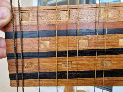

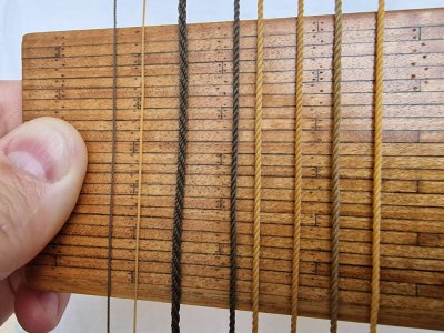

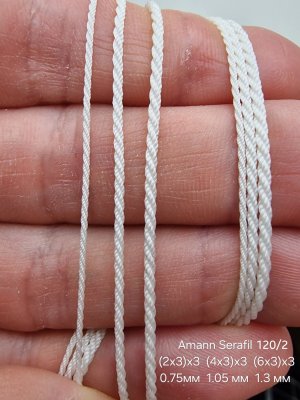

Part 3.

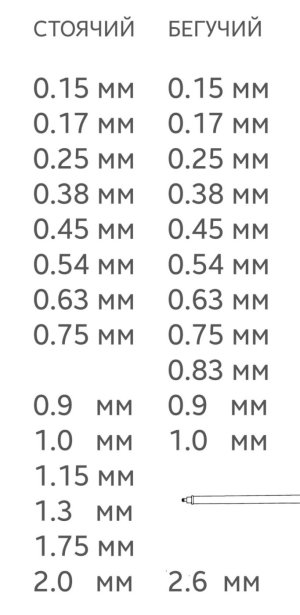

In this section, I cover:
- the types of threads I use;
- how I calculate the thickness of the rigging;
- I provide a table and thickness diagrams for the HMS Victory;
- I show samples of finished threads with descriptions of how many strands they consist of.
You can read all about this in detail in the main construction thread - >>>thread samples and their calculations<<<.
Part 3.

* I updated the information regarding the calculation of rigging diameters based on the diameter of the main mast. I added a table in the previous post, part number 3.

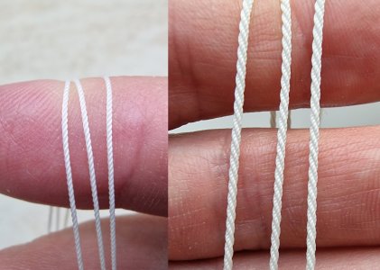

Part 4.
Painting Rigging Threads.
In this section, (linked to my main building thread), I will explain how and with what I dye polyester threads for rigging.
I will discuss which threads I dye, the colors I use, the types of paint, and the ingredient ratios needed for dyeing two different color scheme options.
>>> The dyeing will be done with oil paints.<<<
Part 4.
