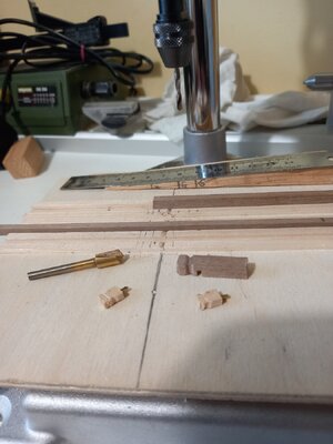

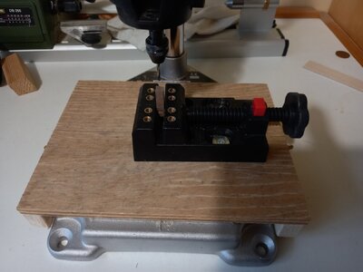

The first one has a small clamp that will slide left/right mounted on a board that straddles the base and slides forward/back. It can be secured if necessary using the wing bolts. The first photo below shows a bitt positioned for drilling into its end. The second jig has a series of strips glued to a base and spaced to receive 3, 4, 5, or 6mm strips. These can be slid left/right to drill a sequence of holes or pushed forward under a small V router to cut a notch. The shallow wedge with a cheap ruler attached is for setting the height of the router tip. For example: if it rests at 80mm on the ruler scale it will cut a 1mm notch in a 6x6 mm strip.

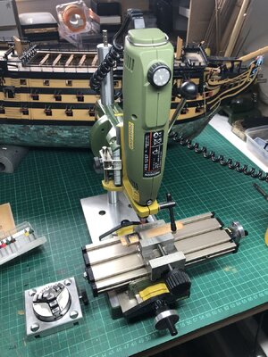

This is the set up I use, it is very handy you can do most things very accurately and keep your fingers. I also bought the index chuck which i haven't used
yet. The little jig I used for drilling gun port lids.
Ah! That's better. Your setup is impressive. I hadn't clocked that the table could be used in conjunction with a Proxxon clamp to get the configuration I wanted though the particular Proxxon clamp you show doesn't seem to appear in the current Proxxon catalogue. The one shown (MS 4) doesn't refer to fitting the compound table. How the table + clamp would combine with a Dremel drill press is a great unknown.
