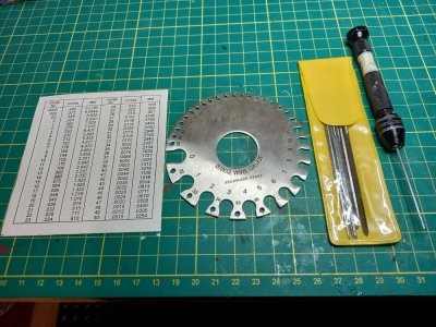

Two minor additions to the toolbox
The wire gauge is nominally calibrated with (British?) SWG numbers 0- 36 (= 8.23 - 0.193 mm) but has the metric equivalents on the other side and came with a conversion chart. While not as accurate as a digital caliper it is easier to keep handy for quick checks of the sizes of holes needed to accommodate belaying pins, stanchions etc. and confirming the actual size if fine drill bits. It is also useful for checking the profiles of wooden strips from the mixed bundle of offcuts.
I bought the set of broaches/reamers after seeing them referenced in a post (#266) by Smithy. I did not know such things existed before that. Simple, cheap, and very useful. Much better than poking a sequence of drill bits into a hole, finding the one that won.t quite fit and using it as a reamer.
This leads me to wonder: is there anywhere on the SOS forum that lists small, non obvious tools? Clearly most of us have the small saws, tweezers, drills, cutting knives etc that form a basic kit. A list of non-essential but handy items (say limited to <$20) would be an alternative to spotting things on other member's benches. I have bought several items on that basis.
