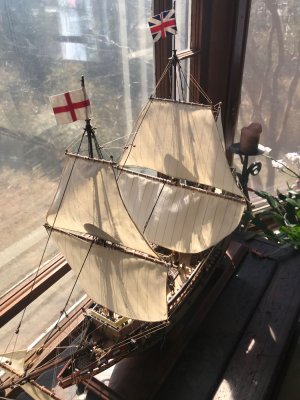

I just finished Model Shipways Mayflower. I rigged sails on it and found that the two crow’s nests are behind the sails. How the lookouts see ahead since the sails blocked their view?
Note that location of top sail spars on attached picture is for furled sails. When you unfurl the sail you raise the sail spar up.

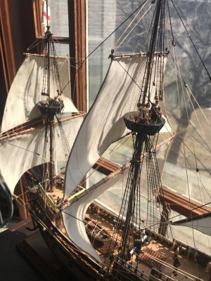

Here are pictures of the sails and their relationship to the crows nests. I appreciate your responses.
The sails were always forward of the tops but you bring up a great question. I thought the lookouts were usually farther up. The tops were designed to support the deadeyes for the top masts shrouds and they also served as "fighting tops" in battle but maybe they were also used at times by lookouts even though the visibility would be more limited than at the upper mastheads where they could see farther due to the added elevation.
