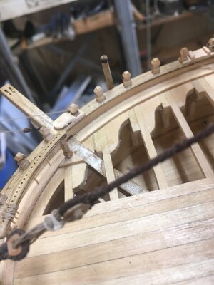

I'm rigging the Discovery1789 with open cut away decks. There will be a few spots where coils/hanks of rope will want to lay over the spots where there is no deck. Do you think I should put in a few short pieces of planking where ever this may happen. In the picture there may be a few coils of rope where things are belayed to the timberheads. I'm thinking the coils would look odd draped over the deck beams or laying on the knees:). I can't find any pictures of what others have done in this situation.

On old dockyard models that were rigged the planking is often along the outer edges of the deck and the gaps central. So ropes belated there have somewhere to cal home.
On old dockyard models that were rigged the planking is often along the outer edges of the deck and the gaps central. So ropes belated there have somewhere to call home.
Thanks. That's kinda what I was leaning toward. I'll have to remember how I joggled the planks. It will be a nice break from rigging. That can get a little tedious. Just finished the braces.. Now on to the sail rigging.

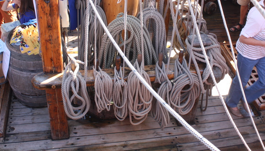

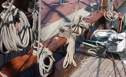

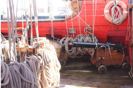

I would hang them as much as possible over the timberheads
The seamen tried definitely to keep as much as possible of the rope material away from the deck

The Frigate "Shtandart"
