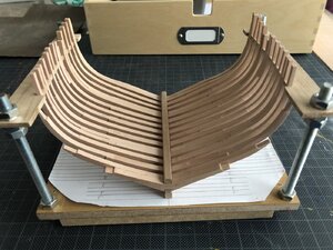

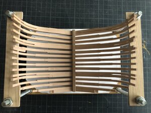

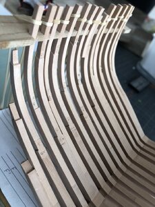

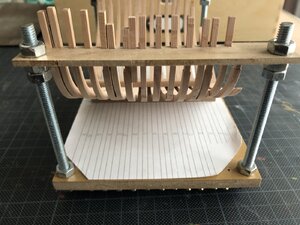

Yesterday I finished the treenails on the frames.
I reinstalled them in the jig and faired the inside.The outside will be faired once the thickstuff over the floors and the toptimbers are installed. I hope that will work without breaking the frames.

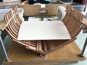

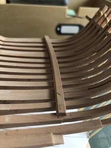

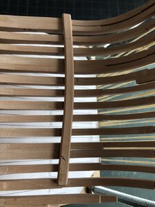

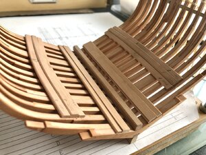

I cut out the thickstuff and footwaling planks following the curve of the floor heads or the chocks. As I understand the planks do follow this line, at least amidships.
Is that correct or do they have to run straight?
I just laid the plank on the frames as they would have to be bent before gluing them.

Hello DST,
The thick stuff does curve as it goes aft following the curve of the frames. I am currently working on a cross section of the Victory and the thick stuff does curve. I will attach a photo so that you understand what I mean.
Thank You, so I'm on the right track then.
The curving starts at the first double frame aft of the dead flat frame 0. That looked a bit strange at first. I can't find any drawing in the AOTS book that would clarify this.

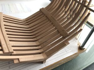

The sides of the frames are coated with oil as it will be difficult to reach those areas after the frames are glued in.

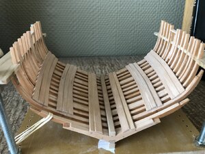

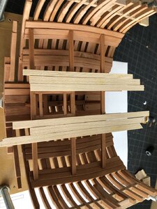

I cut the limberstrake and footwaling and temporarily attached it with rubber cement.
I took the measurements from AOTS and converted them to 1/48. Although it still seems the limberstrake is too wide/tall?!
Hello Dan,

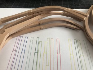

I believe the purpose of the thick stuff material is to have a suitable area in which to add bolts to the frames where the scarf joints are located. Looking at your progress it seems to me that you hit the nail on the head buddy. She is starting to look real good. Take heart and continue what you are doing. Before you know it, you'll look back and think to yourself that she was an easy build.
Raymond

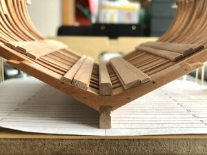

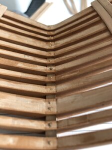

Frames are treenailed to the keel and keelson attached. Still need to do the bolts.

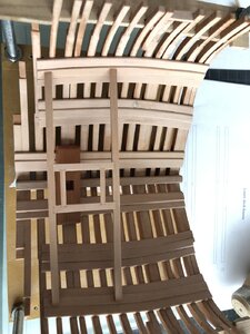

I transferred the position of the lower deck to the frames and checked/finetuned the marks wit a piece of cardboard.
All the planks are glued in place.
Gunport sills are installed.Looks a bit rough but once the outside is faired it should turn out fine.

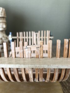

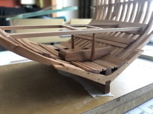

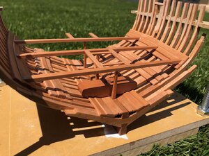

A somewhat bigger update today:

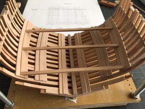

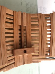

The lower deck beams are cut and filed to meet the angle of the thickstuff strake.:

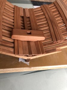

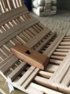

There are only a few ledges and carlings on the lower deck. Here are the ones around the mast:

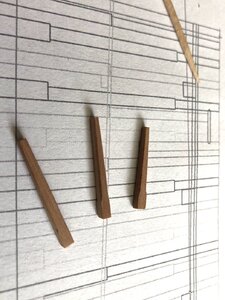

The pillars are shaped to taper from the bottom to the top. This was done with sandpaper attached to a piece of glass and sanding the four sides an equal amount while pressing the top with one finger and pulling it over the sandpaper. The result is not so bad. I chamfered the edges a little:
I suppose it's OK to post the images full size?

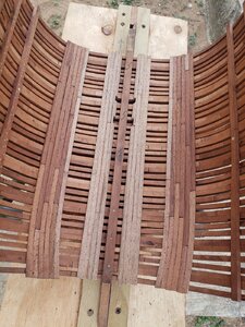

I treenailed the keelson and finished the limber boards. I'll leave some of them off to show the interior.

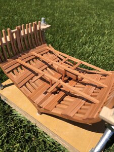

A few photos taken outside to see the oiled effect.

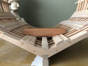

Now I have to decide how much of the planking I want to do. I like the contrast of the maple and the pear. These are not the final planks, just some scrap pieces to test out the look.
