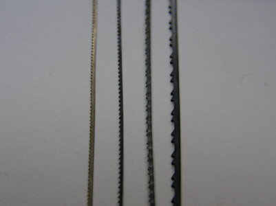

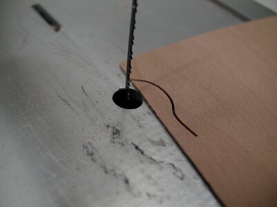

Sometimes simple mistakes happen even to professionals and they clamp the saw blade the wrong way round, for example. The cut must be downward.

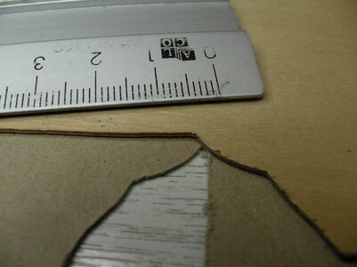

You can also adjust the saw blade to the respective cut. From left: a very fine metal saw blade, then a normal wood saw blade, then a saw blade with 2 teeth each and a coarse wood saw blade. With all of them there are different results when sawing wood.
Cut with the coarset saw blade in 0,7 mm solid wood. Above and below a clean cut..

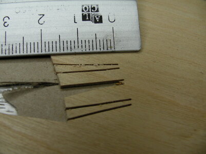

Cut in 1 mm plywood with a cartboard (or even wood) place underneath when the wood tears out.
Cut from below.
Cut from the top and that with the coarset saw blade.
Narrow cuts against the grain are also possible.
For "difficult cuts" or when sanding on disc sander I always sacrifice a base of wood, which is processed with and then discarded. With bad wood, whether veneer or solid wood, processing is often problematic and it make sence, if you have tried everything, to exchange it for another wood. :mad:

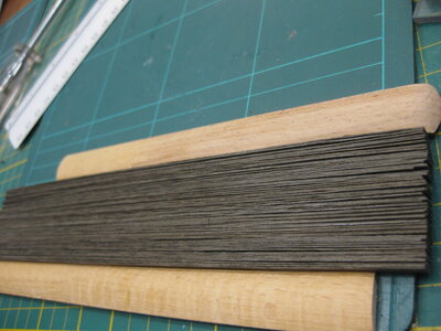

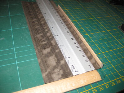

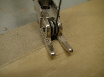

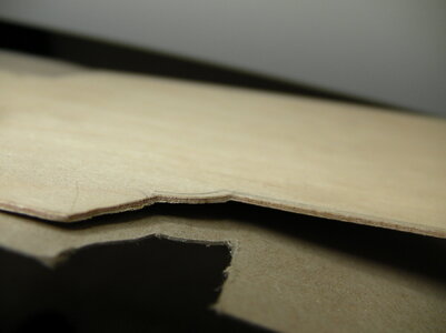

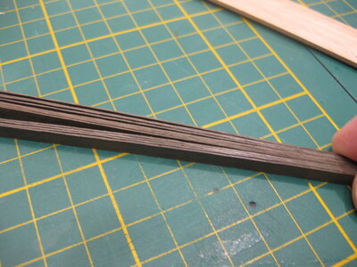

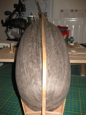

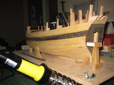

I used a lot of veneer to plank the ships. This is how I do it:

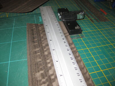

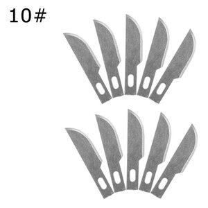

I got the best results with these knives:
The roundness of the knife makes a straight cut in the veneer without splinters, a straight knife like x-acto follows the grain of the wood. and gives bad cut's.
I put a extraa cutting mat under the veneer en let the cutter go along the side of the mat to get straight strips.
I don't even need to sand them
And glue the to the hull using white glue and a soldering iron to heat the strips. Put glue on both sides and let the glue dry for 75% before I put the strips on the hull, then with the iron heat the strips on the hull and the glue melting and fixed the strip.
View attachment 212017View attachment 212018View attachment 212019View attachment 212021
View attachment 212026View attachment 212022

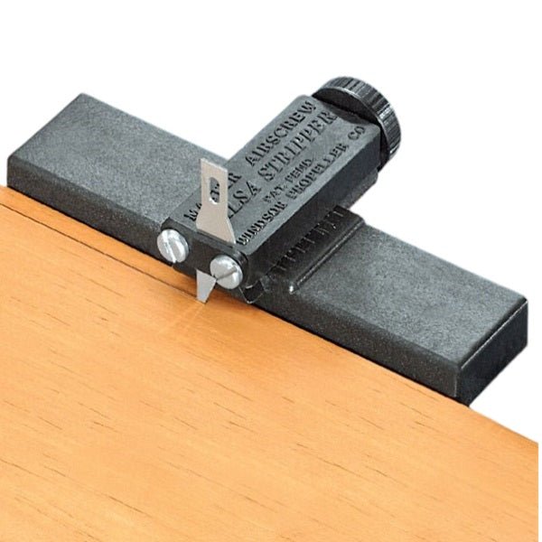

Hi Stephan
Can you tell me the make of cutter you are using?
Thanks
JK
I modify it by put a piece of straight plexiglas on the bottom to get a straight and strong slider. And using round knives (#10) to get a better cut.
It cost me a lot of veneer to find the best way to do, and you see the straightness of the cutting strips that this way is good.
Edit. Even the screw I fix With strong tape when the distance is good

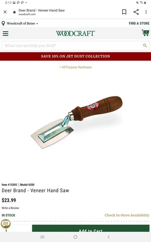

Use a veneer saw. There are YouTube videos ow to use a veneer saw correctly.

In post #6 the way I do it. I cut in 1 maybe 2 cuts. Not necessary to wet the wood. I cut very dry veneer in that way. But use the half round X-acto knife number 10. Other knives will follow the grain and you need to cut more than once. With the round knife you got straight cuts like I showed in post #6. I tried a lot of ways to do it. But this way gave the best result and easiest way to do.
