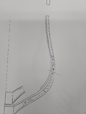

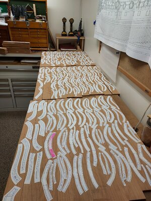

Hello everyone I'm getting ready to cut out the timber frames & futtocks & I know I have to add 1/8" inboard & out for midship frames, 1/4 " for the fore & aft frames, I am wondering what line I should be going by I know the dotted lines & the inner lines are for the fairing radius , I guess I'm asking if I should be adding to the outer lines, this is my first scratch build & If you look at the one's I have glued down I added when I cut the patterns out so I think I should be cutting right on the paper line , I would love any suggestions or opinions, thank you have a great day

Wow! That's a lot of sawing huh? Scrollsaw? Will you be using a drum or reciprocating sander to reach the lines? I don't think I'm quite ready for full-blown scratch building, but it is attractive...lots to learn!
Good preparation.
I suggest to make a test of cutting, glueing together the double frame and sanding with the spindle sander.
Just prepare one complete frame with everything necessary, so you can check best the way and where you cut.

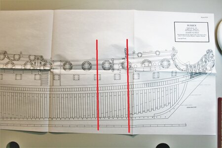

Do not choose a frame of midship, because there are the differences too small, better is one of the marked area
Do not forget to update your building log of your HMS Sussex !!
