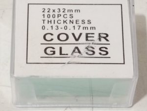

I am trying something new to me on my Santa Ana build.Instead of using mica to glaze the stern windows,I have bought some of the small,super thin glass microscope slide cover slips.Rather than destroy several working out the best way of cutting these,I thought I would ask the question as I know a few members have used these before.So has anyone any tips for cutting these?I was thinking of scoring with a diamond burr and snapping.I don't have a diamond cut off wheel for the rotary tool and would rather avoid buying one just for this task.
Kind Regards
Nigel
I have answered my own question.Using a piece of scrap wood as a guide and the coverslip on a flat surface the cut line was repeatedly traced with the burr.This results in a cut without a breakage in 90% of attempts.What I didn't realise is I had bought 200 cover slips!Enough for many models so I can live with the wastageROTF

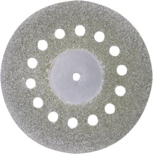

Hi Nigel,
Thanks Maarten,I will buy one and give it a go Thumbsup Those are exactly the same thickness as mine,just mine are 22mm square
