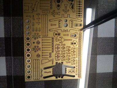

Parts are laser cut..... can't even get jewelers saw blade thru openings.
Finally used jewelers screwdriver ground sharp and small mallet to nibble thruIMG_20220505_202721.jpg

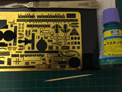

I can't remember who, but there is a youtube video advising not to use a cutting mat to prevent distorting the brass. He used a ceramic bathroom tile with possibly some masking tape.
Place the PE fret on a black ceramic tile or black glass and cut the pieces out with a sharp X acto blade or sharp hobby knife.. Once cut and burs or nibs removed with a diamond file put a tiny bit of masking goo on the small PE piece and using a toothpick placed on the masking pick it up and carefully place onto whatever part of the model you wish. The masking will rub off without damaging the PE. Be careful when cutting because the small items have a habit of pinging away and disappearing for ever or/and getting eaten by the carpet monster. Photo shows what I use for PE. " black glass, #3 cutter, Mr Hobby Masking Sol R, toothpick and naturally super glued fingers (not shown)" Takes a little practice but awesome when done. Hope this isn't to confusing for you - cheers.
