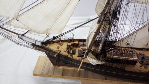

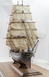

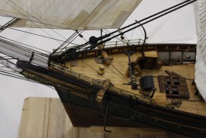

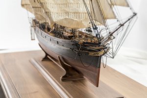

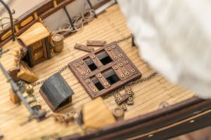

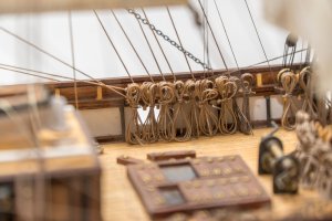

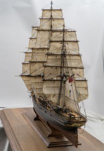

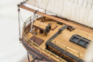

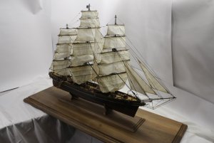

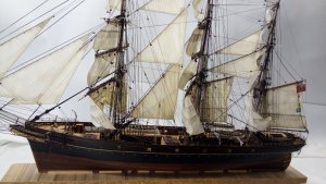

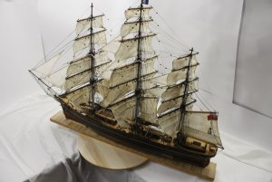

Greetings!

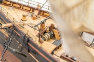

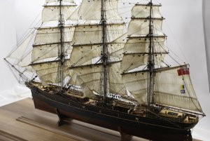

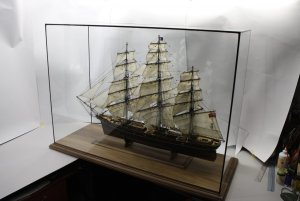

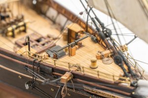

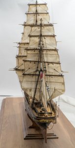

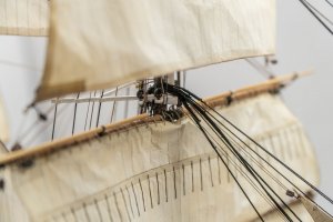

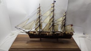

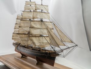

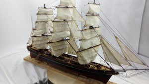

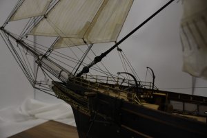

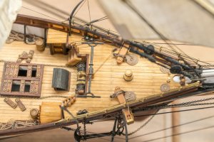

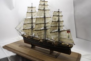

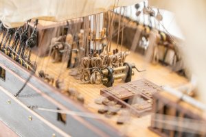

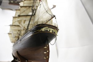

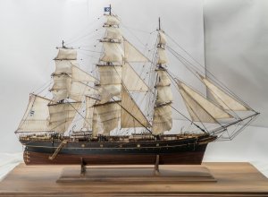

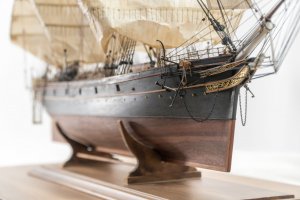

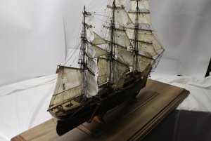

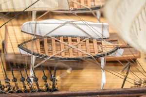

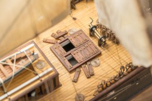

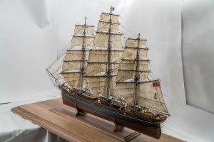

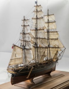

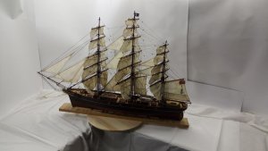

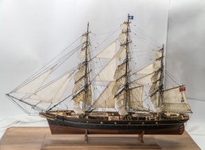

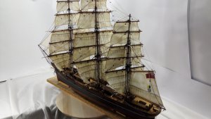

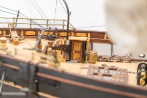

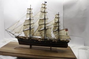

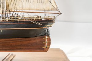

This is my Cutty Sark - 1/84 scale.
The kit is by Artesiana Latina - an entirely wooden model.
Production time - about 3000 hours.
The hull is made of walnut, the decks are made of maple.
The masts are walnut and beech, the sails are not fabric - I used the same technology as Le Soleil Royal.
Here is the pictures:
211.jpg212.jpg213.jpg214.jpg215.jpg216.jpg217 (1).jpg217.jpg218.jpg219.jpg220.jpg221.jpg222.jpg223.jpg224.jpg225.jpg226.jpg227.jpg228.jpg229.jpg230.jpg231.jpg232.jpg233.jpg234.jpg

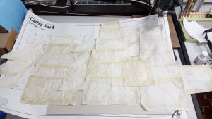

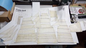

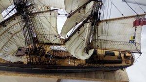

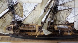

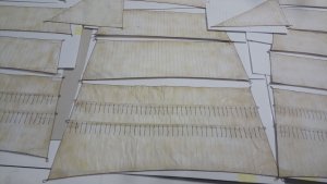

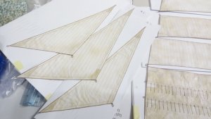

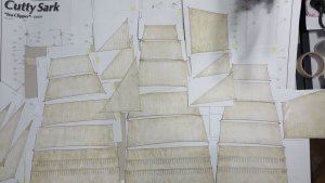

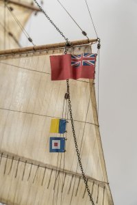

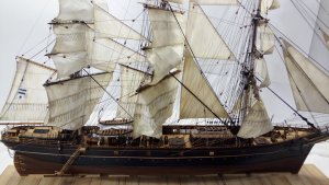

Are your sails made of sailcloth? They look very nice, did you treat material for aged look?
I am learning about sails, near that stage on my current build.
They are from nylon bags - You can find in any supermarket :)
I use airbrush to color them in base white, then again with the airbrush with some brown color I made them to look aged :)
The vertical lines in this scale I made with pencil.
The surround rope is sinthetic tread :)

Genius, with such simple materials and to suck good effect
