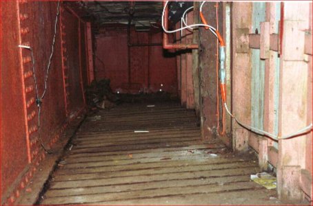

There are things on ships which are placed in a certain position, I take the hawse pipes for example as they require the Sheer plate to be cut and the trail boards to be built around them, they did not move but they are wrong in both the mentioned plans and located in between the wrong frames.
The ship underwent many repairs and reworked, that is correct but the some stuff does not change and that's what I was referring to. None of these plans are drawn to that level of precision or detail which is the whole point.
Anther example is in Longridges book he makes mention of the planking on the pop between the Liverpool house and break of the poop as running athwartships, this is impossible unless the deck was false and laid on plywood which it could well have been at that time as the whole deck was "fake". However the framing of the poop has zero longitudinal frames in this area, you have the break of the poop which has an angle on top with a 9" stringer plate to carry the margin and plank ends and another canted beam which forms the front of the Liverpool house and nothing else so planking had to be lengthwise as usual and as it is now on the ship.
This is the space looking from Port to Stbd and the Iron poop break plates on the left, the second shroud stay can be seen in the back rivetted to the bulwark plates
